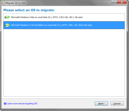

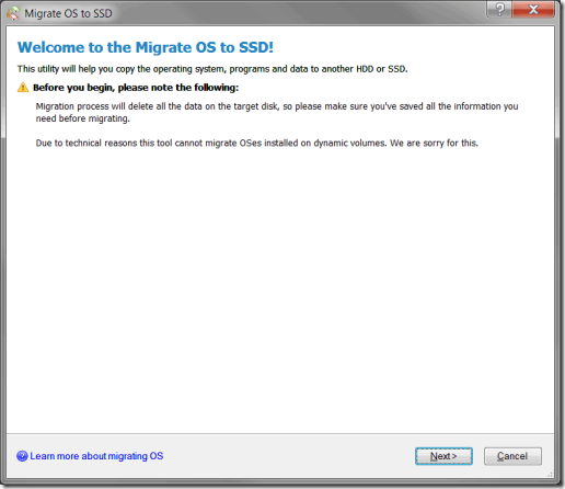

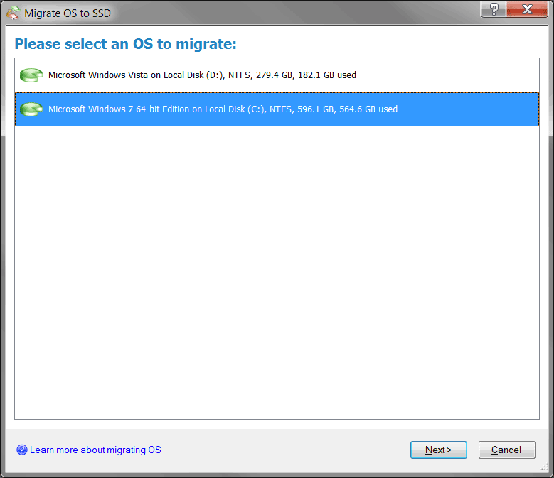

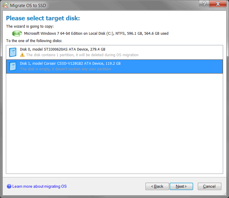

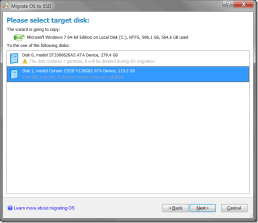

After the welcome screen, and detection of drives installed in your system, you simply select the OS to migrate, and the target drive:

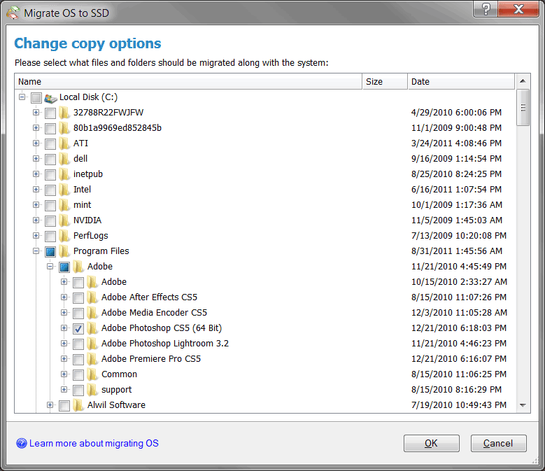

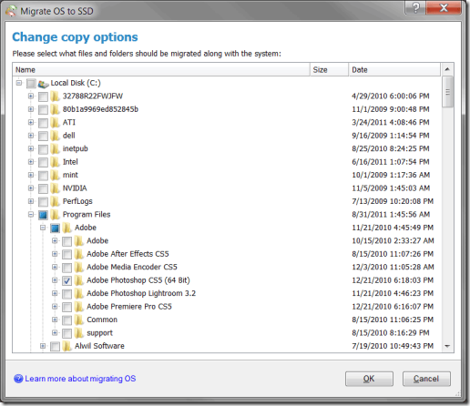

Paragon Migrate offers very granular control. If you have a 64-80GB SSD, you may want to only move Windows. Since I had a 128GB SSD, I also moved all the programs that loaded at startup; Outlook, Trillian, Skype, Microsoft Security Essentials and Malwarebytes Anti-Malware. I also looked at the programs on my Start menu, to find the ones I use most often. Since Word and Excel were on the list I moved all of Office. I also moved Photoshop, my web browsers, Lastpass, and some applications I use for work. While I moved my Windows user profiles, I didn’t move any documents, pictures, videos, or downloads.

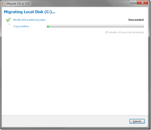

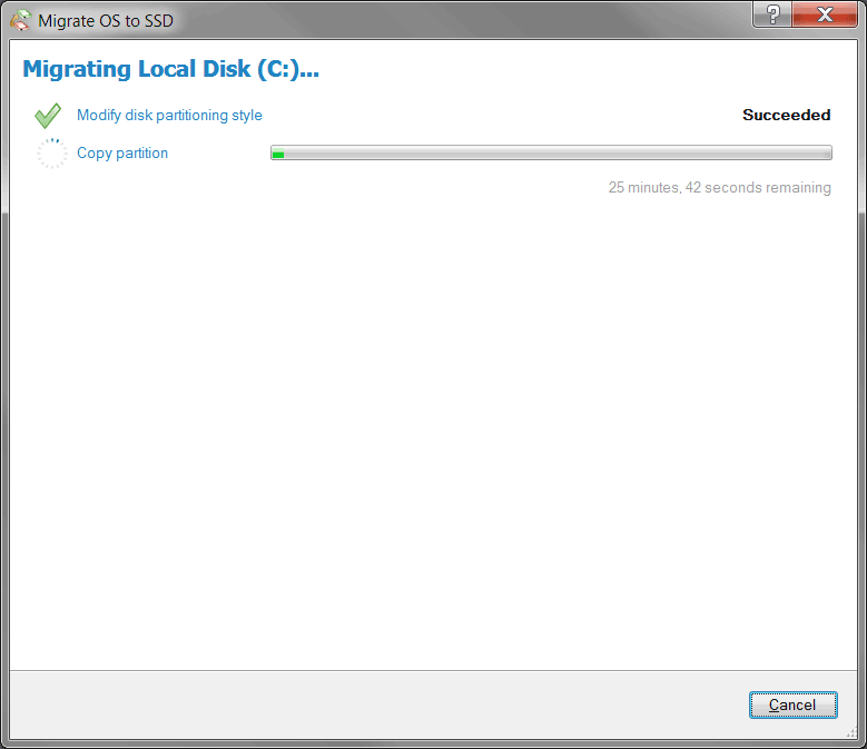

Then it was time to sit back and wait. Even with a fast HDD and SSD, migrating many gigabytes of data takes some time.

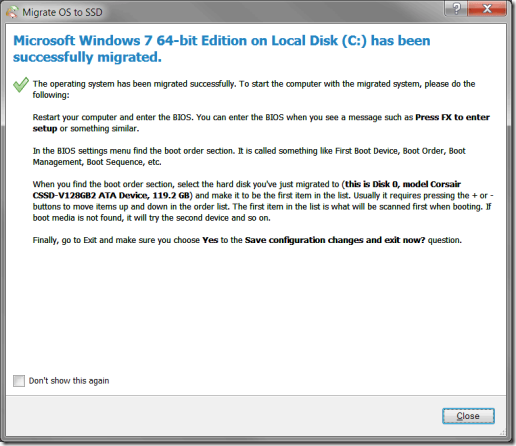

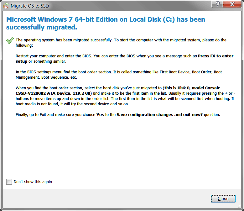

Success! I think the entire process took a couple hours. Most of the time was spent waiting for the data to move, and didn’t require sitting in front of the computer.
