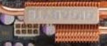

There's a 4-pin cpu fan port that I had already plugged in. I found the connector for the psu connector but the psu connector is too wide to fit in the space provided for it on the mobo. There are no other connectors coming from the psu that come close to resembling the port for the cpu power connector. I'm attaching a photo of the cpu connector on the mobo and an extremely rough hand-drawn sketch on the schematic that shows the shape of the connector (right under where I wrote ATX 12V 2X on the left hand side). Is there an adapter that I can buy that has nothing coming off the sides that I can connect to the psu connector on one end and into the port on the mobo?
Also, I connected the video card to the PCIEX16 port and the HighPoint PCIe 8-PORT CARD to the PCIEX4_2 port. Is this okay?
