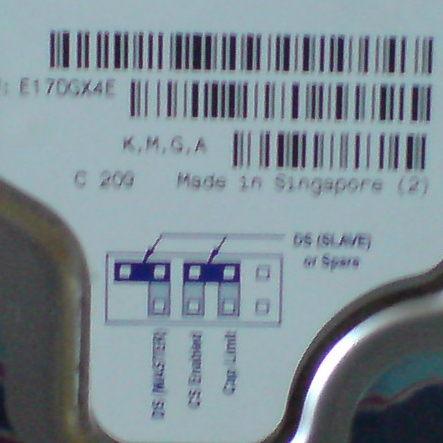

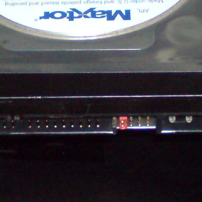

Posted 09 May 2009 - 02:26 AM
right its easy, but if you get stuck then let me know,
find your ubuntu hdd and locate the jumper at the back, set it to master,
on your windows hdd set it to slave,
locate the ubuntu hdd at the end of the ide cable and locate the windows one in the middle
enter your bios and select the ubuntu hdd as first hdd
boot your pc normaly, you should be in ubuntu

here are 2 pictures, one is of where the jumper is on the hdd, the other is a settings diagram which should be on the top of the hdd,
let me know if you have any problems
Posted 09 May 2009 - 08:30 PM
hey thanks it works thank you much for the help
