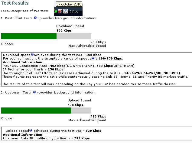

My IP profile for downstream connection used to be around 4500 Kbps, but it has dropped gradually to just 250 Kbps.

I've used a program called "RouterStats" and kept screenshots of line graphs to show when the noise margin has repeatedly sunk to 0 decibels and lead to no internet connection. Cut-out rates vary from 3 minutes apart to 30 minutes apart.
