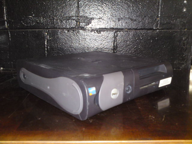

Hi Cejayo2 ;)
My PC specs are in my Profile,
Your specs while they are informative are not very helpful if they are hidden away in your profile :D
I noticed from the Dell specs that there are 5 different sizes of the GX280 case, what form factor is yours?
This makes a difference to your upgrade options regarding the GFX card, as in the height of the card that will fit, low profile, half height, full height and length for example.
Can I ask why you have provided links to Dell for the Ram and the GFX card and chosen a PCI graphics card instead of the much better option of PCI-E X16?
You do not have to pay the prices Dell will charge we can find you some alternatives and then you decide, all you need to do is tell us which size GX280 case you have, provide a budget and tell us what you intend using the computer for, school, studies, office, web browsing or the more demanding gaming or heavy 3D designing.

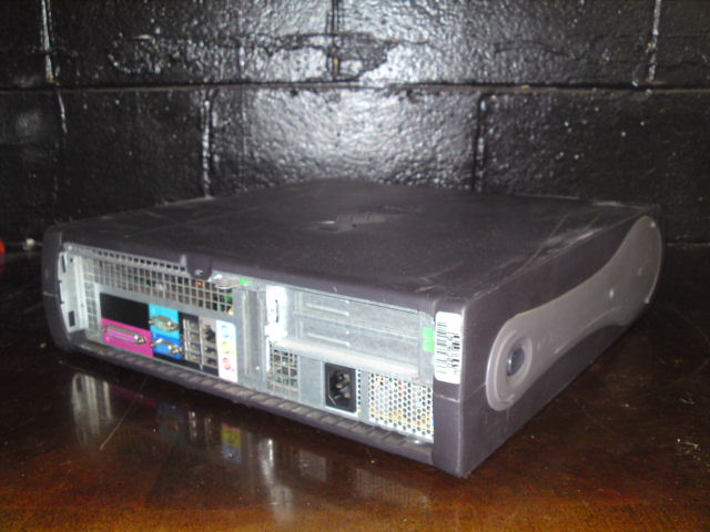

Picture are in attachments of my Box layout

Ive looked at my PSU inside the box, it says i have Max 210Watt.
Are you sure this GFX card is able to run in my box 1k...
Thought i would double check as your above post says 280Watt
Cejayo2
Cejayo2
  • 26 posts
Ive got the Small Desktop 210Watt

  • 24,766 posts
Check the inside of your case and see if you can possibly fit a bigger sized PSU in there.
I found this thread recommending a couple of cards that will work with your present PSU but
I cannot confirm if they will or will not http://www.tomshardw...0-small-desktop

if i remove the PCI Cage i can fit any size in there..
1k, you think ill be able to run a Geforce 6xxx or FX from 210watt
