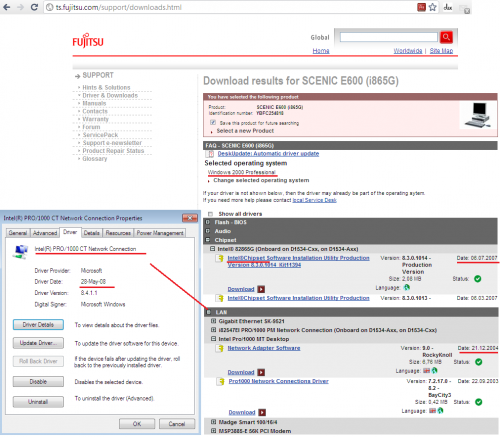

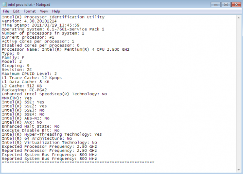

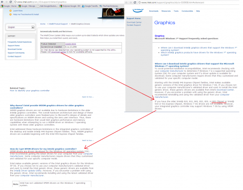

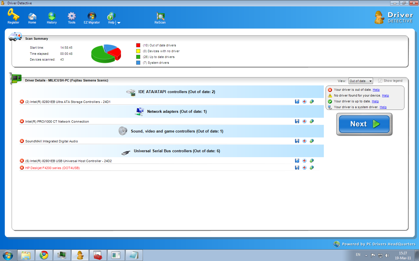

The WhoCrashed program suggests errors with some of my drivers: lan, sound and video. It seems that every time the system crashes there is a different problem. It also says the problems are due to software and not to hardware malfundtions. However, everything coincides with the installation of the new memory module!
This is the first time I have a blue screen on this computer. Is it the SP1 or the new RAM?
I also performed the Memtest86+ which found no errors within the RAM modules.
Can you pls have a look and let me know what I can do?
I will search for new drivers but I am reluctant I'll find updated ones since my computer is quite old, a Fujitsu-Siemens Scenic E600 i865G.
