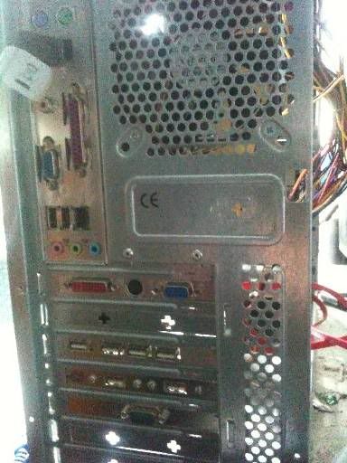

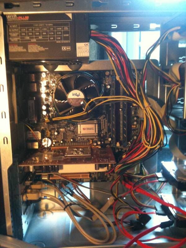

And if these help, here is a internal pic and back of PC pic..
Digerati
Digerati
    Grumpy Ol' MSgt (Ret.)
  • 3,999 posts
Well, you obviously keep it clean. :) Cable management could use some tidying up, and I always replace those wide flat ribbon cables with round cables because the flat cables do a great :unsure: job of restricting front to back air flow. But, that's not your problem here.
Sadly, I still don't have much to offer. If there was a speaker, being factory assembled they should have connected it. I don't see a button speaker on the motherboard - but we don't have full view either. In the back near the bottom, I see a flat multi-colored cable heading to the front panel. That may lead to a speaker, or another two wire cable (that I don't see) might head the same way.
Sorry, but remotely like this, I've got nothing more. If it were on my bench, I might try another CPU and PSU. A trip the shop might be in order, but then again, it is a 5 year old computer - it may be time to look for something new, current, and a whole lot faster than that one - and cheaper than £1550.
