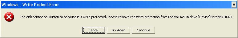

Yesterday I installed some updates to XP and not soon afterwards my flash drives (when plugged in) have somehow been set to read-only. As these drives are used primarily for backup, I have now lost my main back up source. I've looked at drive properties in various places including:
Start|Administrative Tools|Computer Management|Disk Management
but cannot find where I can reset my flash drives status. When sometimes when I access the drive directly with a file manager (in my case I use Total Commander) I am presented with the following dialog:
Although it infers a HDD problem there are no issues with the Hard Disk. I have a feeling I may need to roll back one or more of the recent updates, but if there is an easier way to reset this I'd appreciate knowing how to. My immediate instinct was to go back to the previous restore point but I'll wait and see if there's a simpler way.
Please note - there are no physical switches on the flash drive(s) to change them to read only, so this is being done by the OS somehow.
TIA for any help

Busdriver12. You can try creating a new key under Control called StorageDevicePolicies (exactly as typed). Then create a new DWORD value called WriteProtect and set it to 0.
Reboot and see if the problem is resovled.

Partial success.
I have 3 flash drives - 2 8Gb and 1 16Gb. What I did was to combine the data backed up to the 2 8Gb drives onto the 1 16Gb drive to add an extra level of redundancy to my backups. My 8Gb drives are SanDisk and the above fix has worked for them, however the 16Gb drive which still is shwoing up as read only.
Delving a little deeper, I checked the properties tab in the Hardware info for each drive, and the 2 8Gb drives show up as SanDisk Cruzer. The other 16Gb drive shows up as Generic Flash Disk USB Device. I'm not sure if it's related in some way, but this may have something to do with why this drive is unwriteable. Once I get this solved I'd like to be able to figure out how this change was made and what I need to do to prevent it from happening again. Now that my smaller drives are able to be written to I can heave a sigh of relief as I am bit of a back up freak and there was a level of anxiety in getting this problem sorted.
Thanks for all your help so far :)
