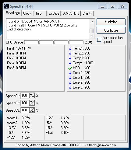

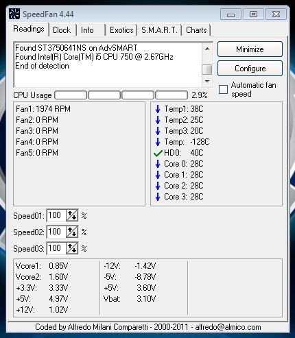

Now 3 weeks into all this I'm out of ideas and would greatly appreciate any help. To help with it, below I attached an /sfc screen, speedfan screen, cpu-z report from my current system installation and recent dump files.
