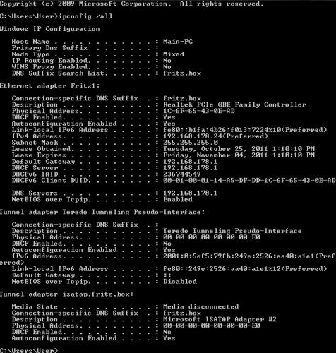

I ran ipconfig (see attachment.)
Which one is the IP address that I am looking for IPv4, or Default gateway? :)
How do I set the SMC to be on the same network, what shall I look for?
Then I need to set the Default gateway to this IP address that I found in ipconfig, correct ? Is this setting a static IP address?

The IP address of the modem appears to be 192.168.178.1, which is what you need to set the default gateway to on the SMC. You will need to connect the SMC and then login to that to change the settings. You may also need to login to the modem to see what DHCP range it is using to ensure that the SMC does not give IP addresses in the same range. The modem seems to have set your machine to 192.168.178.24.
Once you login to the SMC, there should be some setup options. You need to set the local IP address range to 192.168.178.X. The DNS settings should be manually set, instead of automatic, which would be to the modem, 192.168.178.1. This would also be the gateway address for the SMC. Basically all the traffic from the SMC out needs to go through the modem, 192.168.178.1.
