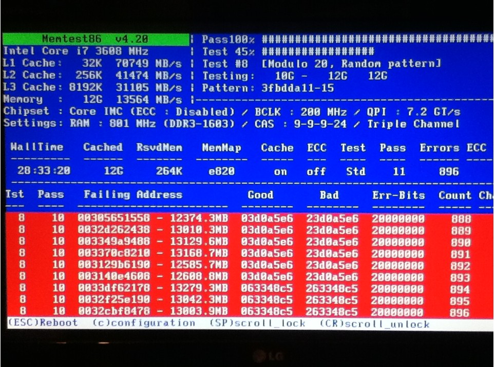

I also did another run on Memtest86
Wich gave the following errors :
-=[PICTURE LINK]=-

I tested every RAM-piece
This time none of them gave any errors.
RAM 1 :
-=[PIC 1]=-
RAM 2 :
-=[PIC 2]=-
**This one tested for 9 hours the first time. But forgot to take a picture so did another 5hr test**
RAM 3 :
-=[PIC 3]=-
So any ideas on this situation ?
Greetz dOCTAWAALd
Edited by dOCTAWAALd, 07 June 2012 - 09:44 AM.
happyrock
happyrock
    Tech Moderator
  • 9,285 posts
only put 2 sticks of the good ram back in...they should be in the same colored slots...whatever color is closest to the cpu
then go here and run the AMD Driver Autodetect detects your graphics card and operating system and tells you if a new driver is available. If there is a new driver, the tool will download it with a click of a button and start the installation process...after the install reboot

happyrock
happyrock
    Tech Moderator
  • 9,285 posts
when you run 3 sticks of ram your system will only run in single channel mode...
2 sticks will run in dual channel mode that nets you a higher throughput...
when you replace that bad stick it has to be the exact same make and model number or you can have more problems...
try uninstalling your video driver...then run the auto detect again...that way you will get a fresh copy...

happyrock
happyrock
    Tech Moderator
  • 9,285 posts
well whats this then if you have no errors...as long as the sticks have no errors they do not need to be replaced...only if they have errors
