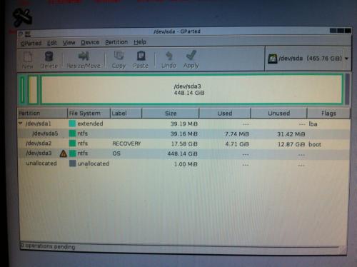

May I suggest something before that first? To the techs, please correct me if I'm mistaken. And I apologize if this is a waste of time.
To robinshawn, you said that you deleted recovery partition. Did you do anything else at the time related to the partitions?
It might be that the main active partition no longer exists (and so the Partition Table is a bit confusing for the computer to read) and so a boot flag needs to be set for the partition you're trying to boot into.

The following steps should be safe to do as it doesn't involve changing anything. Just after a picture. Hope I'm not causing any inconvenience.
1. From a working computer, please download the following: gparted-live-0.12.1-5.iso
When you have the .ISO file downloaded, you need to create a bootable CD using a working computer to do that. The .ISO file is a disk image. It should NOT be burned as a regular file. You need a program like BurnAware Free or ImgBurn that can burn an .ISO image.
2. Now, please boot off of the newly created GParted CD. See How to Set BIOS to Boot from CDROM for information on how to boot from the CD.
You should arrive to the following screen:
Press the ENTER key
By default, "do not touch keymap" is highlighted. Leave this setting alone and press the ENTER key.
Next, choose your language and press the ENTER key. English is the default setting [33]
Once again, at this prompt, press the ENTER key.
You will now be taken to the main GUI screen below
Please take a picture of this screen (camera or phone pictures will work just fine), and post it here for us to see.

Ok got a pic from Gparted but can't figure out how 2 put it up & I'm a photographer used 2 attaching pic files 2 everything lol! Gonna keep trying but if no one sees it wen u chk in pleez send instructions.

Macboatmaster hope this helps i'm standing by the computer most of the afternoon.look forward to further instructions.

It does not look good to me, but I will defer to Amlak on this one.
You will have to wait until he comes online

I'm not sure what that exclamation mark indicates, and it doesn't look like the Recovery partition was ever deleted. Am I missing something here?
But give the following a try (if it doesn't work, we can always reset the change):
Go back to that screen.
Under "Flags", Right-click >>>>/dev/sda3<<<< while in GParted and select Manage Flags
In the menu that pops up, place a check mark in boot like the picture below:
Now double-click the Posted Image button.
You should receive a small pop up like this:
Choose reboot and then press OK.
Note: If it won't allow you to do any change on it, please click on the yellow triangle with the exclamation mark and let me know what it says.
