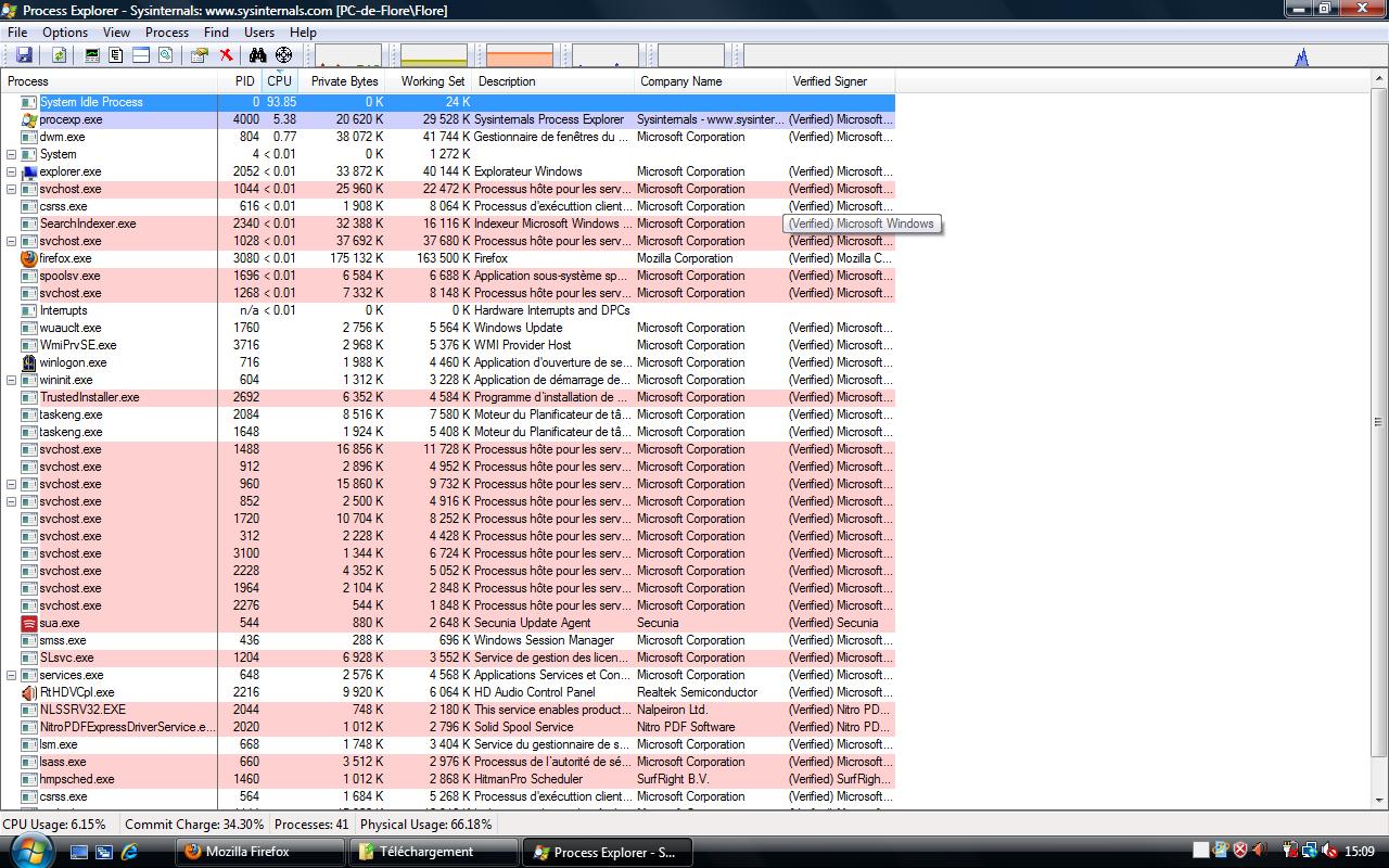

What 'System Idle Process' ? High CPU consumed ! More than 90%
System Idle Process is supposed to be high. We want it as high as possible. It means the CPU is not busy doing other stuff.

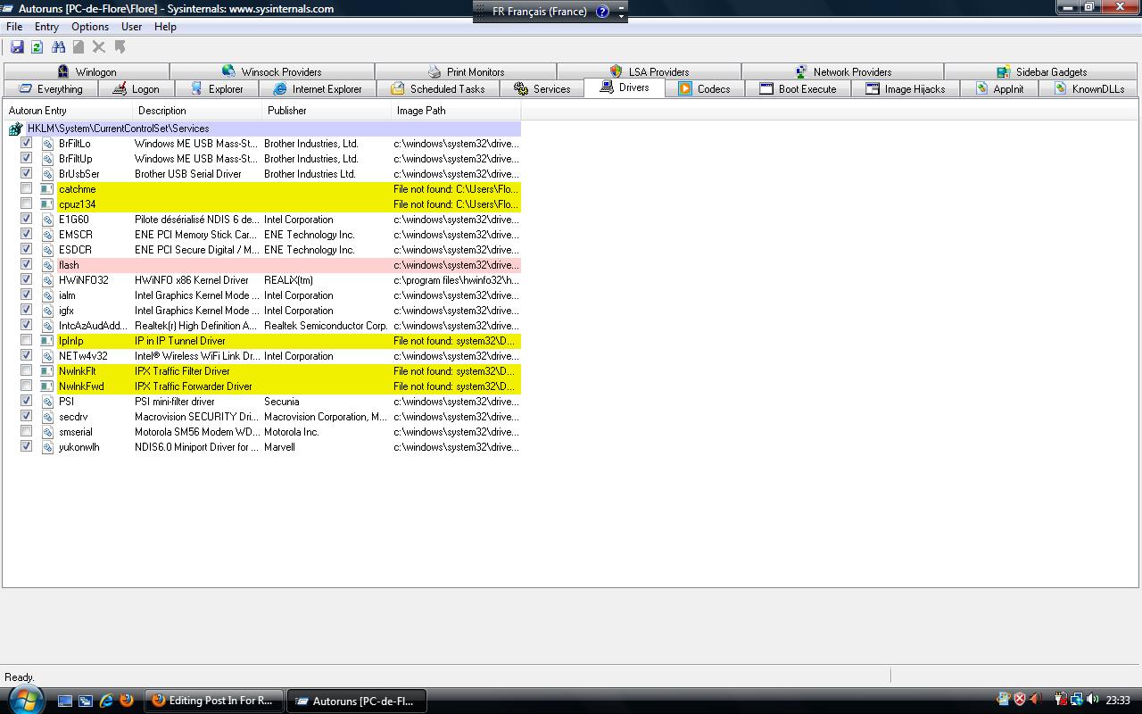

Please check my drivers,thanks
All the drivers, sure ?

  • 21,070 posts
First two are left over from Combofix. You can uncheck them..
The one in pink I'm not sure about. Submit it to Jotti or virustotal and see what they say.
The others are just obsolete or not used windows drivers. I have been told to leave them alone.
The drivers we were looking at may be called for in inf files if they are not in autoruns. I found one post where someone tracked them down to bad paths in an inf file. The Inf files are in c:\Windows\Inf. (The files with the PNF extensions are compiled versions of the inf files and can be ignored for now.)

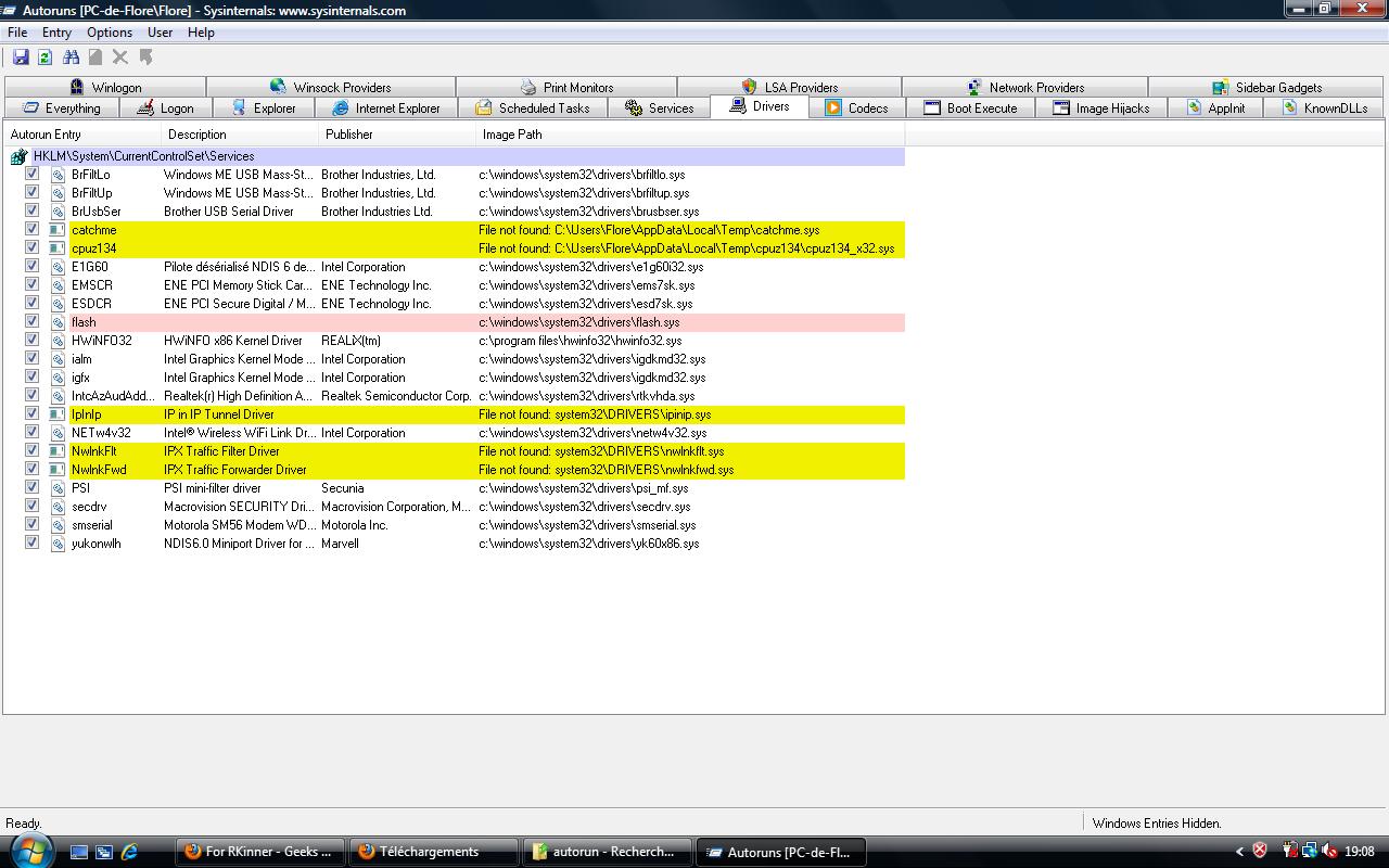

Too late, I disabled all drivers :
Results 1: no more Ksod before 'Welcome Screen' and when closing account, I have 'Please, wait..' and a black screen (for 1 sec) with a dash key on the left upper corner screen. I dont know if I need to consider as a black screen, let me know your opinion, please.
Then, I enable a few more drivers until I enabled all except those appeared on yellow in the previous screenshots My link and graphic cards:
Result 2: the same as before: no more Ksod before 'Welcome Screen' and when closing account, I have 'Please, wait..' and a black screen (for 1 sec) with a dash key on the left upper corner screen. I dont know if I need to consider as a black screen, let me know your opinion, please.
Culprits:
ialm Intel Graphics Kernel Mode Driver Intel Corporation c:\windows\system32\drivers\igdkmd32.sys
igfx Intel Graphics Kernel Mode Driver Intel Corporation c:\windows\system32\drivers\igdkmd32.sys

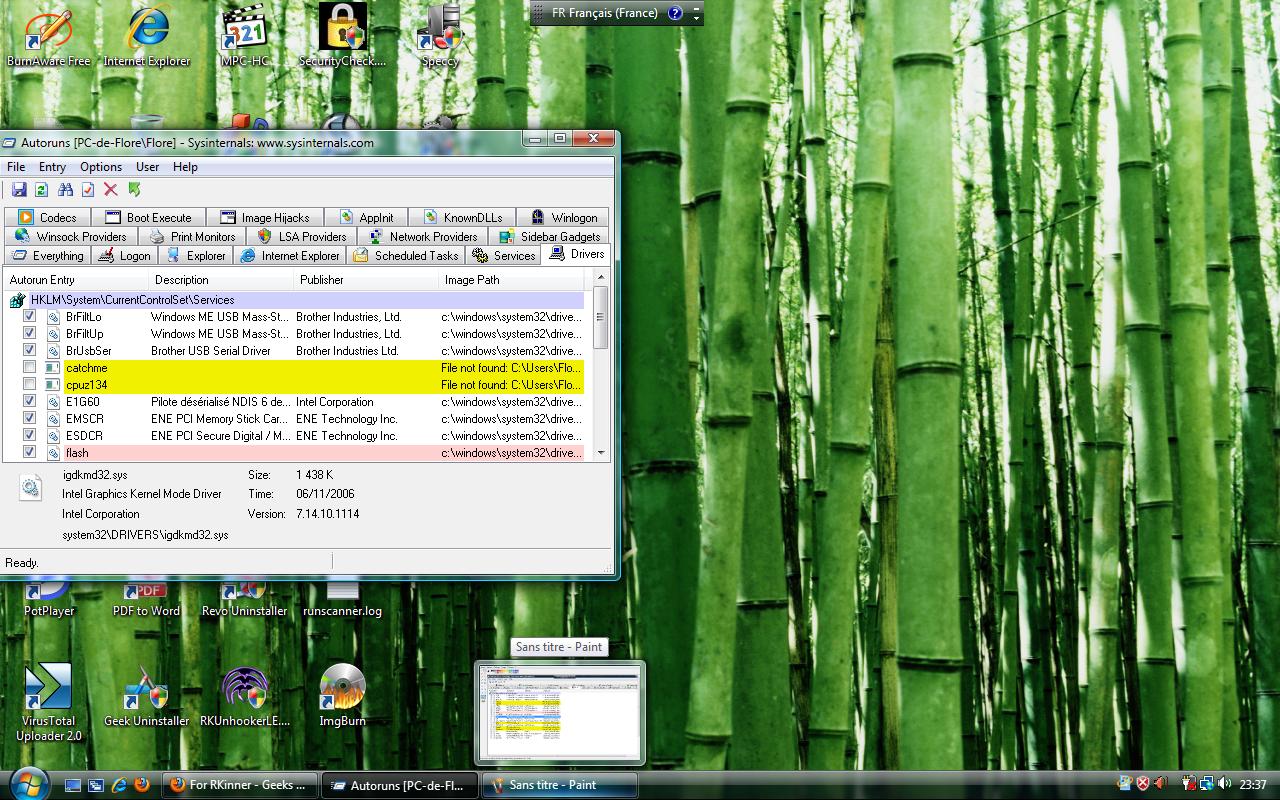

1.Check the new update drivers on Autoruns and let me if I need to disable one or more drivers. (see attached file)
2.Which graphic version driver do I need ? Check the version on the second attached pic: this version is the last from Fujitsu Siemens site. Maybe I would need an older version...

Yours says it is: 7.14.10.1114 and is from 2006
The new one is: 7.14.10.1504 and is from 2008
So I would say that it did not install. Please try winvista_1583.exe again. http://downloadcente...d=2301&lang=eng Remember to right click and Run As Admin
I don't think it matters. You can uncheck them if you want to.
winvista_1583.exe from the link I gave you earlier: http://downloadcente...d=2301&lang=eng
