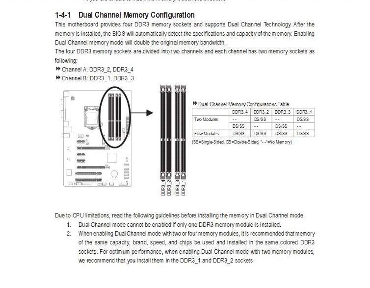

Guys,i have some question about ram.Motherboard Gigabyte b75d3v.
Here is the questions:
1.What if i use 16 GB ram of different brands such as A-Data 4 GB ddr3 1333mhz,Corsair 4GB ddr3 1600mhz,Transcend 8GB ddr3 1333mhz will it hamper my gaming time??
2.What if they have different cas lantency???also different mhz or same mhz but different latency????

If you do not have the same model and quantity your Dual Channel capability will not work properly
Third if you do not use matching ram (2 x 4gg and 2 x 4gb) but instead (2 x 4gb and 1 x 8gb) lots of motherboard will not work under that setup, your motherboard only takes memory in pairs of two, 1 stick (single channel memory), 2 sticks or 4 sticks, a 3 stick combination will not boot
As you caN see from your motherboard manual this is the only setup that will work.
One more thing in your manual they specify that 1600mhz memory will only work if you have an Intel 22nm (ivy bridge) CPU
Hope that helps
