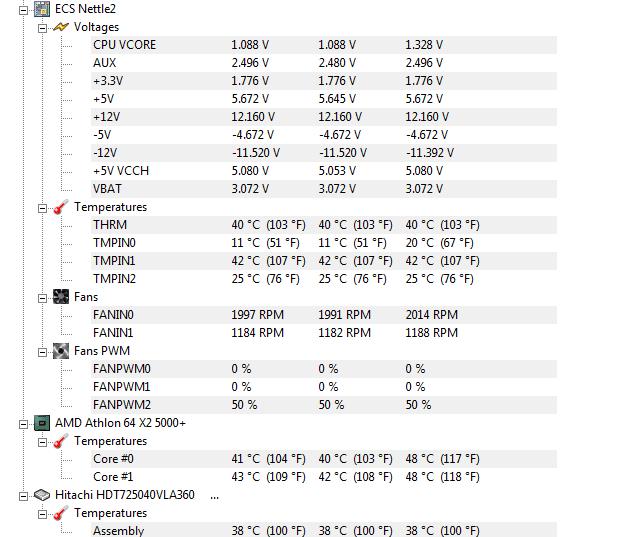

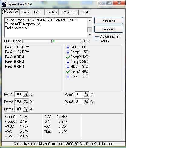

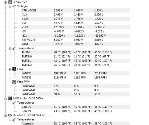

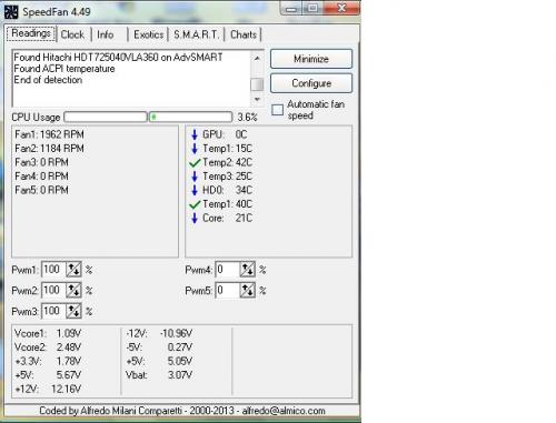

OK I see a potential problem with speedfan so I want to double check it with this next program. Is this a desktop or laptop?
Please download and run Hardware Monitor
Installation (setup version only)
HWMonitor is a hardware monitoring program that reads PC systems main health sensors : voltages, temperatures, fans speed.
The program handles the most common sensor chips, like ITE® IT87 series, most Winbond® ICs, and others. In addition, it can read modern CPUs on-die core thermal sensors, as well has hard drives temperature via S.M.A.R.T, and video card GPU temperature. Please get a screenshot of the sensors window and post it in your next reply.

Yeah that 3.3+ volt rail doesn't look good.
Do you kmow how old your power supply is?
Can you get the make and model of it also?
