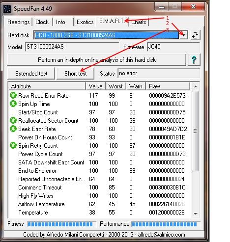

Check your hard drive for failure...
*Download Seatools For DOS from my link; in the site screen, click "DOWNLOADS" tab, then "Seatools For DOS". Burn it to a CD. Reboot with it in your drive. In the screen that appears, first check that SMART has (or has not) been tripped. Then click the upper left corner of the screen for the short test and let it run. It will notify you either Pass or Fail. This is from Seagate Corp. but will test all other drives, not just Seagate. Post back with the results.
If you do get a "fail" notice, or it messages you that SMART has been tripped, immediately back up all your data to a drive off-computer.
Edited by ranchhand3, 04 November 2013 - 03:19 PM.

Worked in SafeMode for about an hour, writing in Open Office, with no problems but couldn't access the internet. I wanted to try downloading something like a movie file while writing, but couldn't do that in SafeMode.
It won't until SafeMode with networking option is choosed. This is my next suggestion - try that and let me know.

Bryan... Your USB/Floppy setting should be the one you need; however, I checked it out, and Seatools does not have an easily-adaptable USB setup. There is one available, but it is a bit involved to adapt it to a USB stick. Instead, download (free) Speedfan and install it. Double-click the launch icon.
1... click the SMART tab
2... click the dropdown box and choose your hard drive
3... click the Short Test tab, and give it a few minutes to complete.
The result will be posted in the Status box, either "no error" or fail.
Definitely follow Naathim's suggestion and have your drive checked out for Malware.
By the Way... if you happen to have a USB optical drive then go ahead with burning the Seatools for DOS and use that. IMHO it would be wise to get yourself one to use with your system, but that is only a suggestion. Windows 7 does have an integrated hard drive analyzer, but it seems to only scan the disk for allocation file errors and attempt to fix those, there is no mention of a physical integrity disk check or SMART check.

Sorry, Ranchhand... couldn't get SpeedFan work. I loaded it but when I hit the dropdown to select my processor, nothing is listed.
Bry
