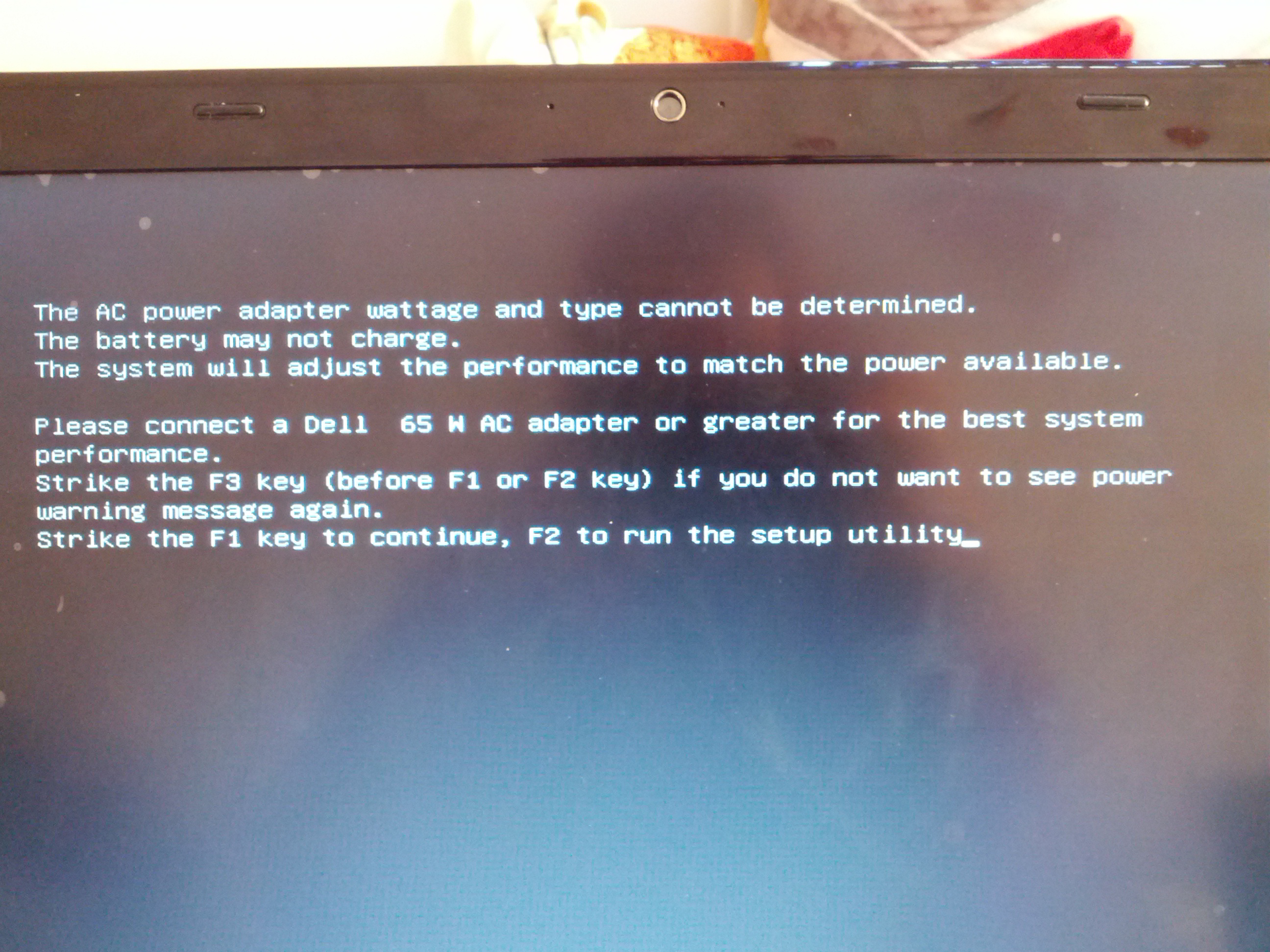

Computer froze after about 10 minutes. Also received a new message on start up about my power adapter. I joined a picture of my screen.

That screen picture shows what I think is a hardware problem, that is your battery seems not to be charging because the computer can't detect the adapter.
Was the adapter connected?

Booting normally was never an issue- it's after 5-10 minutes, everything freezes... So... Yes BUT it freezes after 5-10 minutes.
This message never showed before... adapter is plugged in. I'll check that later or have a tech check the battery/adapter later. There's a computer shop across the road that's called : ''For when people curse at their computers'' :lol: (sadly, when the issue is software, they always turn to formatting instead of trying anything else)
