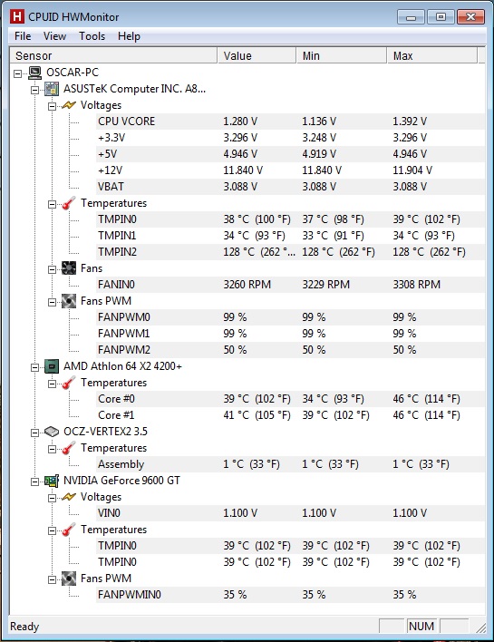

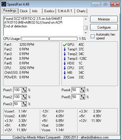

Now I would like to see the PSU health by doing the following. Though this may seem repetitive it will give us a good comparison to make sure the readings are correct.
Please download and run Hardware Monitor
Installation (setup version only)
HWMonitor is a hardware monitoring program that reads PC systems main health sensors : voltages, temperatures, fans speed.
The program handles the most common sensor chips, like ITE® IT87 series, most Winbond® ICs, and others. In addition, it can read modern CPUs on-die core thermal sensors, as well has hard drives temperature via S.M.A.R.T, and video card GPU temperature. Please get a screenshot of the sensors window and post it in your next reply.
Tyskie
Tyskie
  • 58 posts
Hey Ron,
I don't mind repetitive. I fully understand that we have to go through an elimination process as I have experience troubleshooting PC issues, I just don't have the extensive knowledge that you guys have so I appreciate everything you're doing here. I don't know if you know, but SleepyDude helped me solve an installation issue on another PC and that took 3 weeks but we got there and I was 'chuffed to bits' :happy:
I have done as you asked and here are the screenshots you requested:
Thanks for your :help:
Luke.
Edited by Tyskie, 05 March 2014 - 03:53 AM.

Yes for the posting of the BSOD's.
Your PSU seems to be working within the acceptable parameters.
