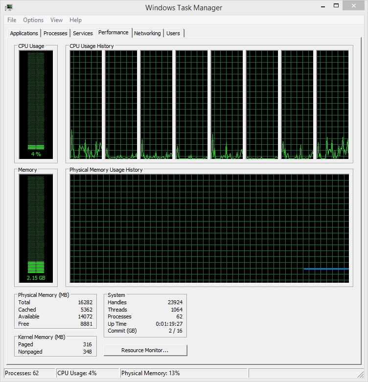

Can you post a screen shot of Task Manager, Performance tab?
I have a Intel Quad Core i7-4770 @ 3.4Ghz and mine looks like this:

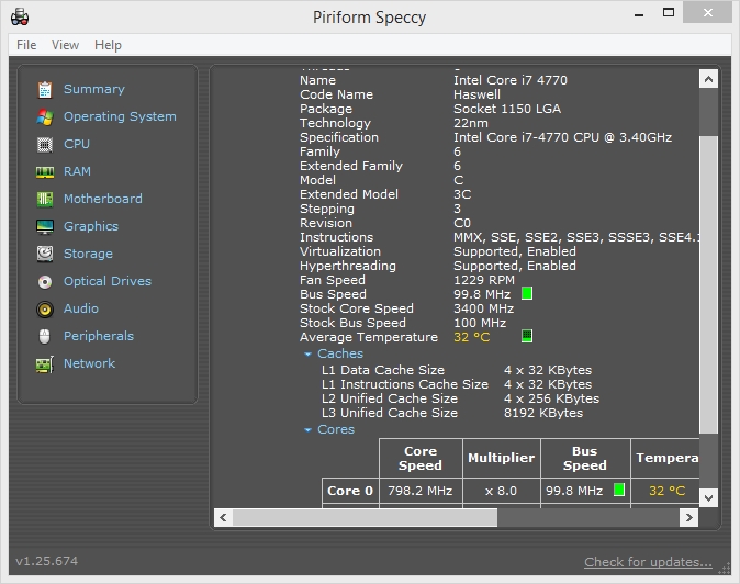

What does Piriform Speccy show for CPU?
Mine is:
