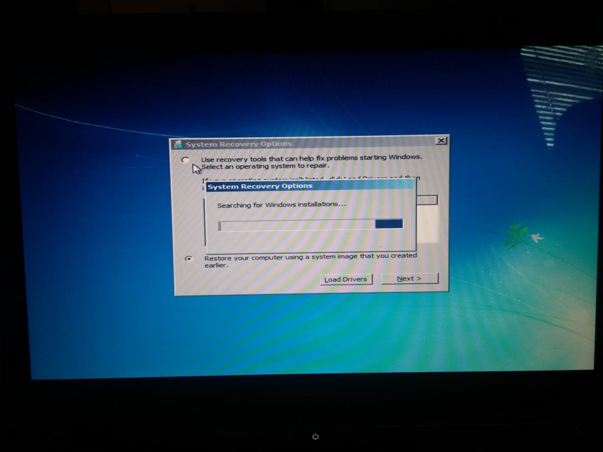

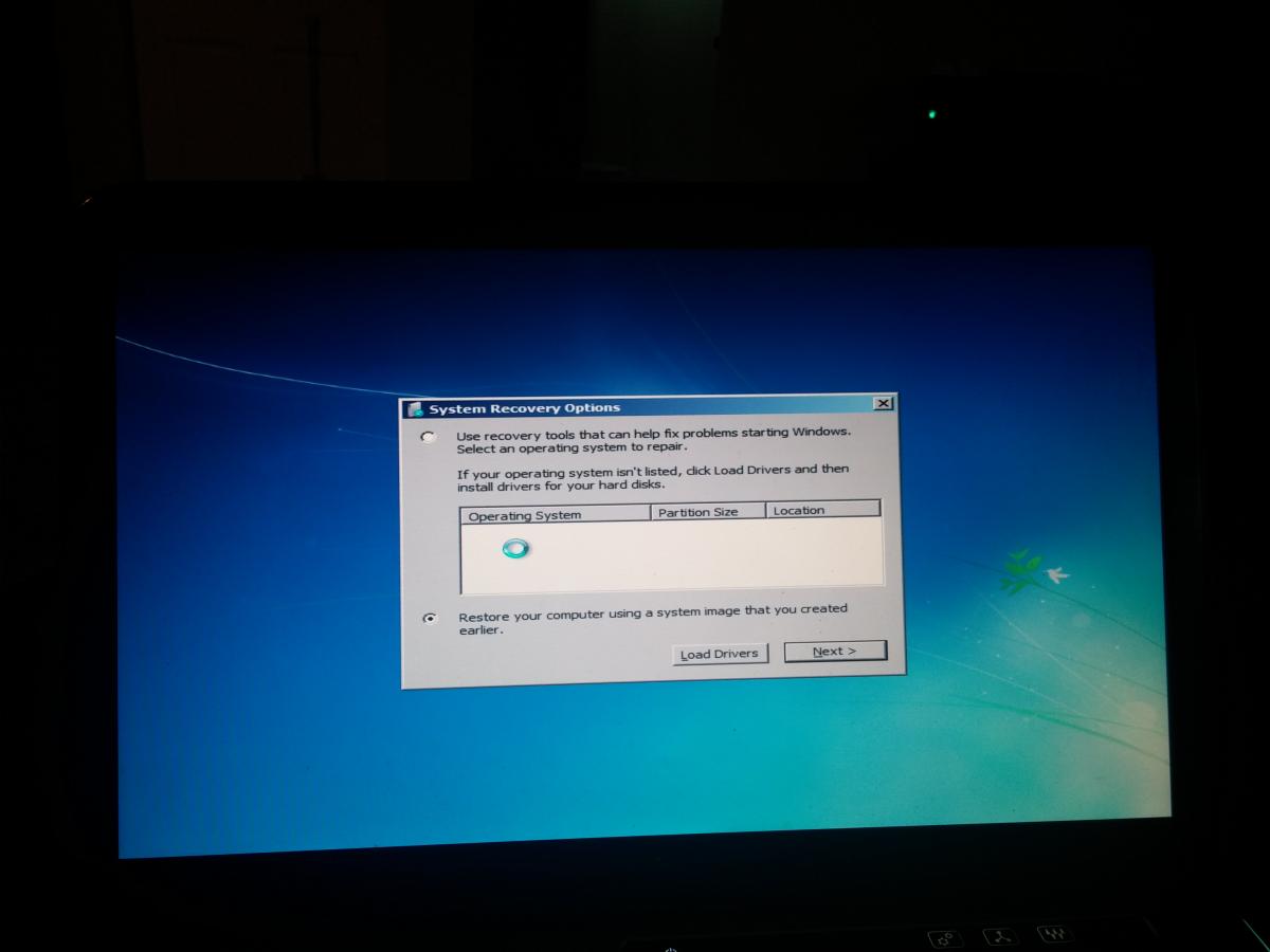

Click repair my computer
Select your operating system
Select Command prompt

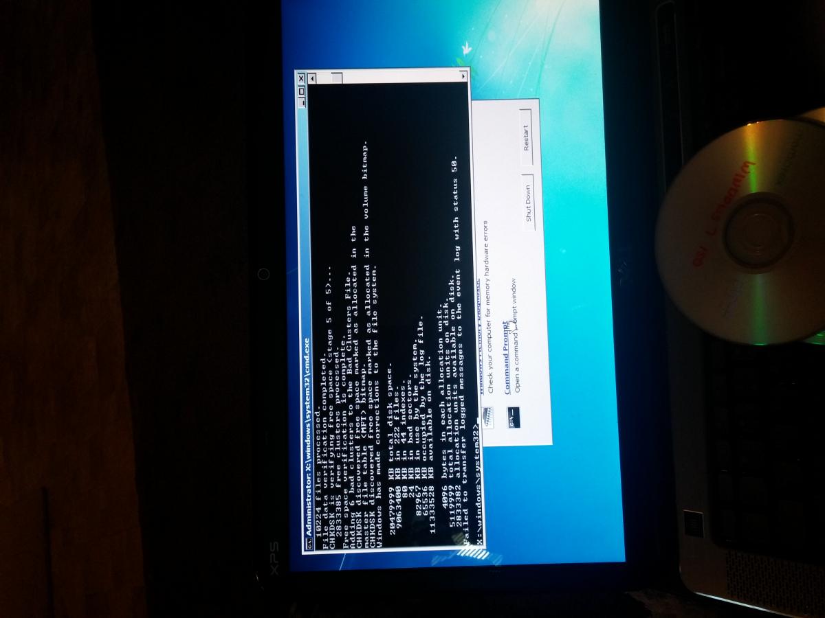

At the command prompt type the following:
chkdsk c: /r
and press Enter.
note there are spaces in this command, as marked red here: chkdsk_c:_/r
This procedure may take countless hours, like a whole day or even longer. Please, let it run uninterrupted.
Upon completion, please try to boot up normally. If no joy, please try to boot up in Safe Mode.
If normal or safe mode will be operational, please insert your USB drive, copy FRST64.exe to your desktop and run a fresh scan (with Addition option checked). Post the two logs it will hopefully generate.
If still no joy, once more start the Recovery Environment and post me a new FRST report from the Recovery Environment, like mentioned in my previous post.

Ok, so after a really annoying day with this dang laptop, I finally have a log to show you. Unfortunately, I had no luck with starting Windows normally or in safe mode.That is good. I hope that after this check we will have more options to go.
Keep me posted
