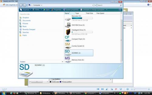

About the drives, you have 2 Internal connected drives called K&J correct ? + Your "C" Drive.
Do you see them in disk Management? See link for disk management access in case you need it.
http://pcsupport.abo...t-windows-7.htm

My computer sees J: & K:, but it calls them removable disks.  I can post a photo because that will certainly be worth a thousand words.  My J: & K: drives are both hard drives that were in my previous computer.  They are not removable devices nor are they memory sticks as they are called in the photo.  When I looked at them with the Disk Management it calls them removable.
I wonder if I could still be having problems because I haven't erased the photos from my C: drive yet?  I copied all the photos, but I was doing some maintenance and clearing out duplicate photos.  I just really wanted to be sure I wasn't erasing anything without a backup copy.  My computer still has only 10% free space.  I'm doing my first ever backup of all my files right now.  It may be finished by tomorrow...
Okay, I've attached the photo to this post.

Go ahead an post a photo, I'll warn you I'm not much on hardware issues, but can at least gather information. I'll be up front, I have no idea why they would be listed as removable because there not connected to a usb.
You could get by with 15% free space although I like 20% but that's just me.
