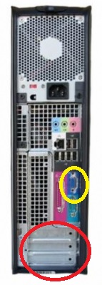

Is the display connected to the Add-in Nvidia card or the on-board Intel video connector?
Posted 04 July 2014 - 02:13 PM
Sorry, I am not following your last question.
Could you clarify, to help me understand how to figure out where it is connected?
How can I tell if the display connected to the Add-in Nvidia card or the on-board Intel video connector?
Edited by My name is Earl, 04 July 2014 - 02:42 PM.
Posted 04 July 2014 - 05:48 PM
Posted 04 July 2014 - 06:03 PM
I am not sure if there is a distinction, but normally it is attached to the 'red area' but I connected it to the 'yellow area' and found that I see a desktop without icons of any sort and when I right click it seems to show that I can do something with NVIDIA perhaps load it, I am not entirely sure what I can do in that connection. As I say normally it attaches in the read area.
