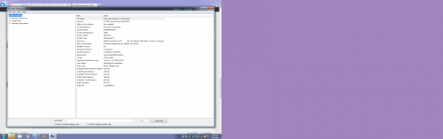

PLEXTOR 512GB SSD SATAII

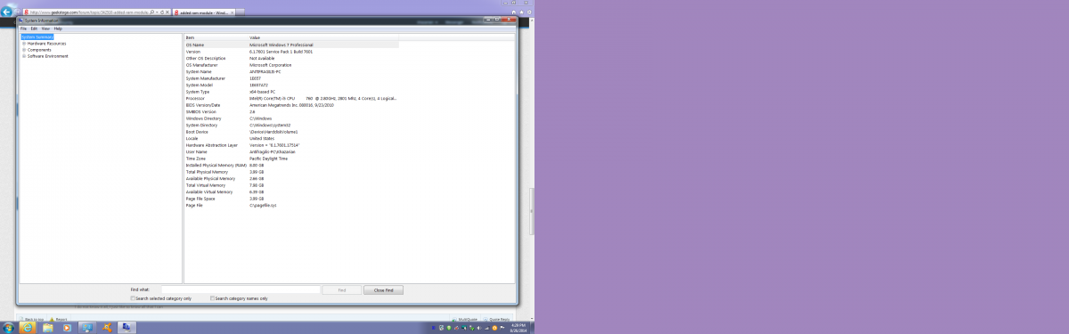

The Bios shows 4gb of ram again.

The BIOS is when you enter by pressing DEL key as soon as you start your computer, the picture you are showing us is once you have entered Windows.(System Information).
The reason I am asking is to verify if the problem is harware (motherboard, ram modules, Bios setting) or software (windows), if it shows 8gb in the BIOS and 4GB in windows then it is windows who's at fault but if both show 4gb even if you have your two ram modules (8gb) installed then we can assume it is a hardware problem or maybe a BIOS setting issue.

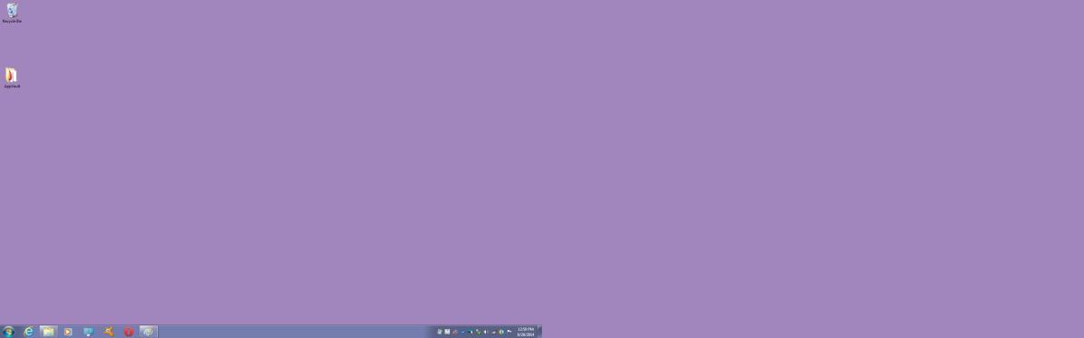

What I did to get hibernation working again was disable and then reenable automount in DISKPART as an administrator.  It's now functioning like a champ. Plus I no longer have the message "This copy of Windows 7 is not genuine" in the lower right portion of the desktop screen.
