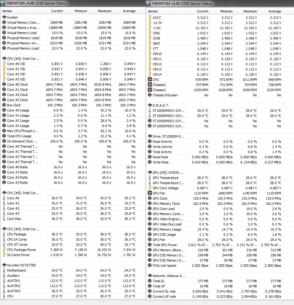

I used the program HWiNFO64 4.46 with "sensor reading only" but there was no "system under stress" option. This is the outcome:

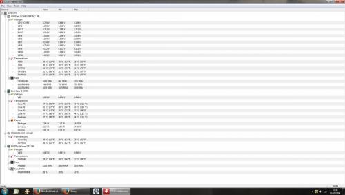

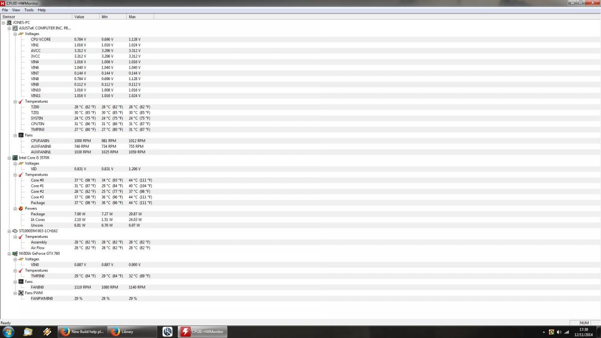

Heres the result of the HWMonitor
Only installed the ASUS suite ii last night but so far it seems ok, still a little unsure though.

The results from HWiNFO64.
  • 24,716 posts
Nothing out of the ordinary there so if the computer remains stable put your GPU through it`s paces with Valley Benchmark (free)) which you can get from here this will test your GPU and put the PSU under load when the GPU requires full power from it.
