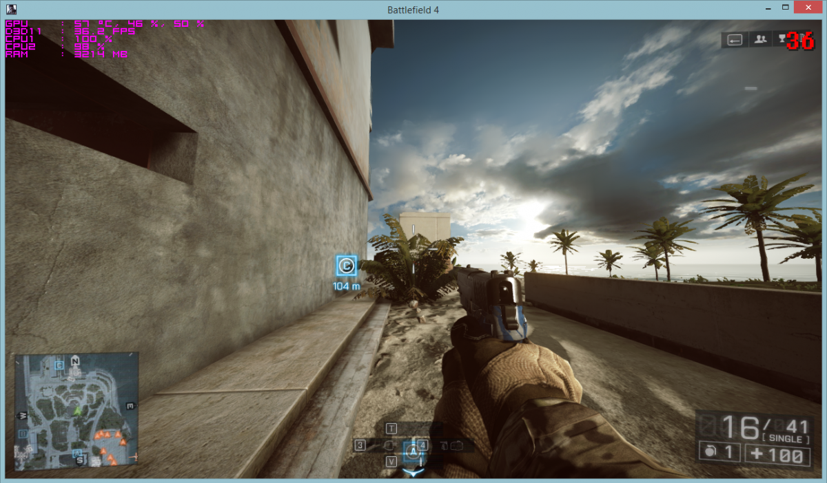

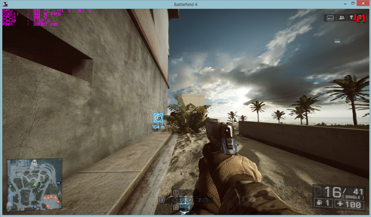

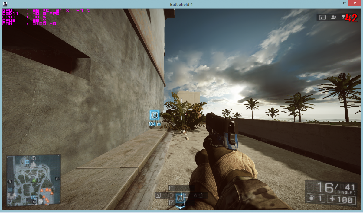

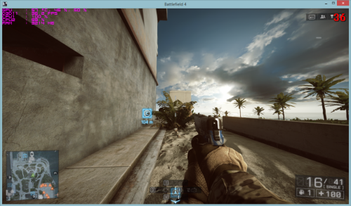

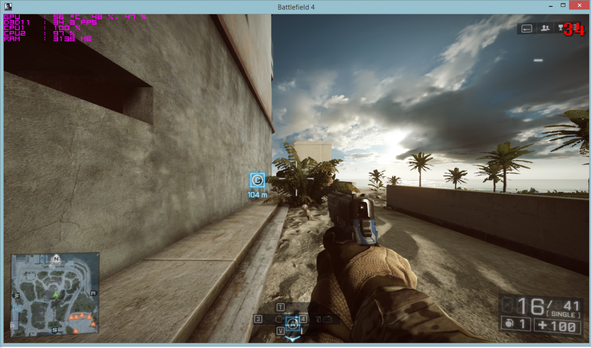

I recently got a new gpu (Asus Amd radeon HD 7750 1gb ddr5) and after going ito some games ive relised my frames havnt changed sinnce my previus gpu (asus gt 730 1gb ddr3) could this be bottlenecking??? i also checked in bf4 on al settings using msi afterburner to check gpu usage and cpu usage and im 99% sure my cpu is bottlenecking my gpu.Here are some screent shots below :

usually the easy way to tell the bottleneck is if the gpu usage is low and the cpu usage is 100% or high then it's cpu limited and vice versa if the gpu is maxed and the cpu usage is low then your gpu limited.
the games make a big difference in where the bottle neck is usually and also because you've changed gpu architecture going from nvidia to amd/ati the frame rates may not have changed much/any because the games may be optimized for nvidia cards so you need a more powerful amd/ati card to get the same frame rates as a less powerful nvidia card.
to be honest i'm not sure just how much of a performance difference there is really in going from a gt 730 to a hd 7750 anyway, both are mid range cards, so the frame rate may just be about the same or an extra 2 or 3 fps anyway.
from your screen shots then yes i'd say your cpu limited, your dual core cpu is running at 100%.

ok but if you look in the screen shots above my cpu cores are at 100% or just under and my gpu usage never goes past 50%.also my specs are:
