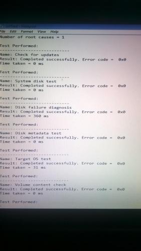

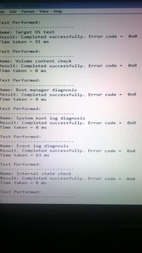

I would like to have a look at SrtTrail.txt file after you run the Startup Repair tool. You should run Chkdsk command because Windows try to repair the file system run the Chkdsk D:  /r command to make sure there is no surface errors on D: partition. If there is no surface errors or they all repaired by Chkdsk command then use TestDisk tool to repair the partition table.

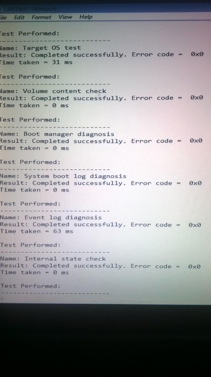

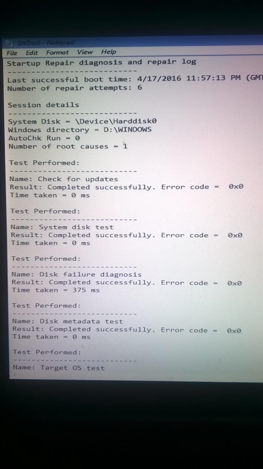

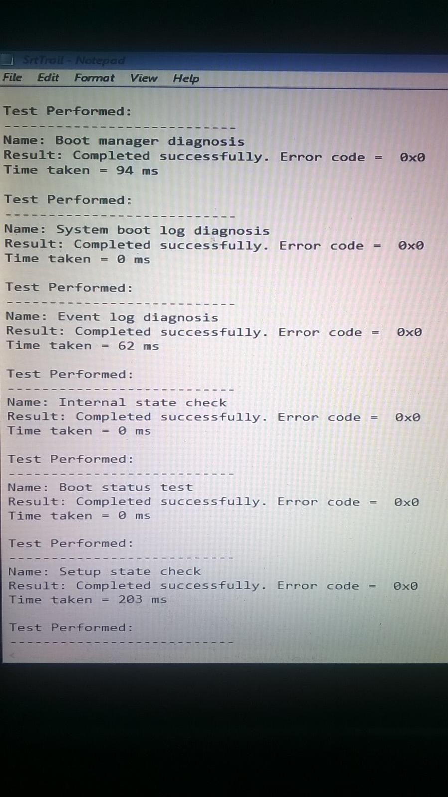

OK, I ran startup repair again. I had the boot USB in if that makes any difference. Attached are the pics of the txt file.

It looks like partition table has been repaired lets leave the partition table for now as log file report NTFS.sys driver corrupted. This is my plan we copy NTFS.sys file from WinSxS folder which also holds cache for Windows system files if this files wont work which we can only know by booting the computer after replacing NTFS.sys file and if Windows wont boot then you have to run the Startup Repair and show me the logs contain at SrtTrail.txt file if NTFS.sys driver is repaired but some other issue come up then i can confirm that your HDD is failing.
From Command Prompt type Dir /S /A  D:\Windows\WinSxS\NTFS.sys now there could be more then one NTFS.sys file inside different folders. Execute Dir /A C:\Windows\System32\Drivers  compare the NTFS.sys file size of this Dir output with NTFS.sys files contain at subdirectory of the WinSxS folder. You want to copy same size NTFS.sys file. Use Copy command to copy and replace NTFS.sys file store at C:\Windows\System32\Drivers folder. Type Copy  D:\Windows\WinSXS\NTFS.sys    C:\Windows\System32\Drivers command.

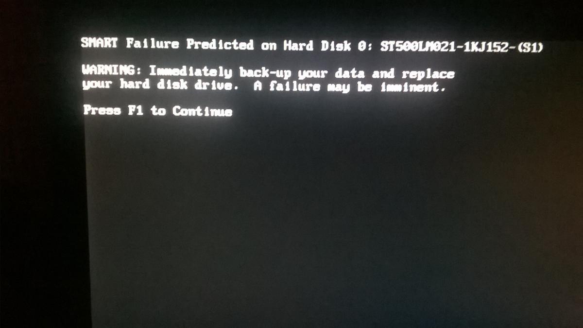

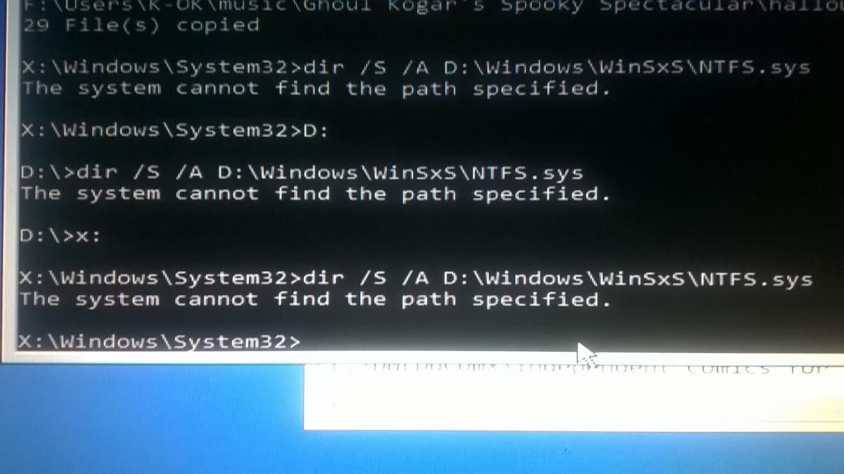

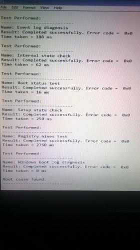

Hi, Freebooter, I'm back. Because my external HDDS are smaller than my computer's HDD, I had to do a lot of juggling and a lot file management to save the rest of my files (I realized a lot of my video and comics files are now hard to find online, so I couldn't let then go as originally planned)...I've not slept. Nor dis i get a chance to DL that utility you wanted me to get.
But I tried your idea to replace the NTFS.sys file. I got the error in the first image.
But it may not matter, b/c when I booted, I got the error in the 2nd image!
Any chance that message is wrong?
Also, another file question: I can't seem to get to my FONTS folder via cmd. I think it's in the Windows folder...i can't even view it from the cmd prompt. When I did a directory search for any folder named Fonts, I got"access denied."(I had NO passwords set on my user name or any folders in Windows). What do I do? I've a lot of unusual fonts that I use for art and video projects and the like.

FreeBooter
FreeBooter
    Member 1K
  • 1,460 posts
As i thought your HDD is failing you will have to replace your HDD there is no reason to continue with troubleshooting its hardware that is malfunctioning nothing to do with software. Hard drives use S.M.A.R.T. (Self-Monitoring, Analysis, and Reporting Technology) to gauge their own reliability and determine if they’re failing.
