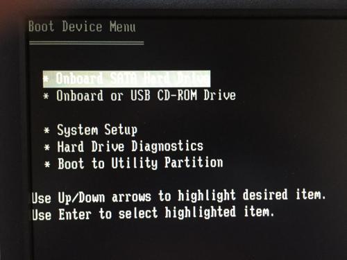

johnb69
johnb69
  • 102 posts
I swapped back the drives and XP boots OK.
I have attached the pic of the boot menu.
John
#131
iammykyl
iammykyl
    Tech Staff
  • 6,802 posts
It seems, unlike a regular BIOS, which can sequentially boot progressively from multiple Boot devices, the Dell one is limited too two devices.
Take a look at img 2210 in Reply #128.   we will try moving Drive 1 SATA 2, up one, place in the boot order.   Refer to the Manual bottom of page 112, "Changing Boot Sequence" > https://www.manualsl...page=112#manual
After making the change, Save setting, > confirm, > press Enter.
Fingers crossed you arrive at the Desktop.   Start Disk Manager, the SSD should be at the top of the two disks, Save a screenshot.

#134
johnb69
johnb69
  • 102 posts
When I hit enter on that screen with the onboard SATA Hard Drive highlighted it boots to XP.
John
