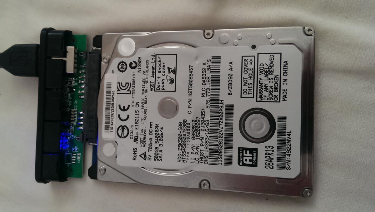

Ok, first I need to know the brand and model of the two HDD's you have.
Edit: Do you have another external USB Hard drive with plenty of free space?

That's the old hdd, and inside one as I was told.

the one inside right now HDST hts725050a7e630  If that helps, but guy told me its exactly same one, maybe diff brand thought.
i do have a back up usb hd that has my files i back up on....it has 25GB free

Ok so both drives have the same size 500GB. Do you have a empty flash drive with at least 1GB in size?
