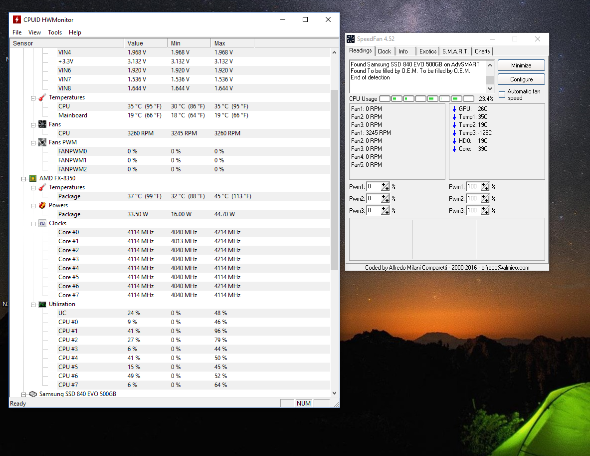

Download Speedfan from here and install it. Once it's installed, run the program and post here the information it shows. The information I want you to post is the stuff that is circled in the example picture I have attached.
Download then run HWMonitor and post a screenshot so that we have a comparison to the Speedfan results, details from here

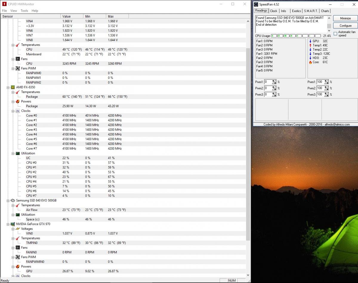

Just to clarify, there are actually 5 Case fans, 1 GPU fan and 1 CPU Fan in this sytem not just a single fan, they are just powered directly from the PSU and not the motherboard.
I see that speedfan reads his core temp as being 61 right now (which is definately something I would be concerned by!), when I checked this last night it was not the case, it was only reading 40
Edit: Forgot to add the screenshot!

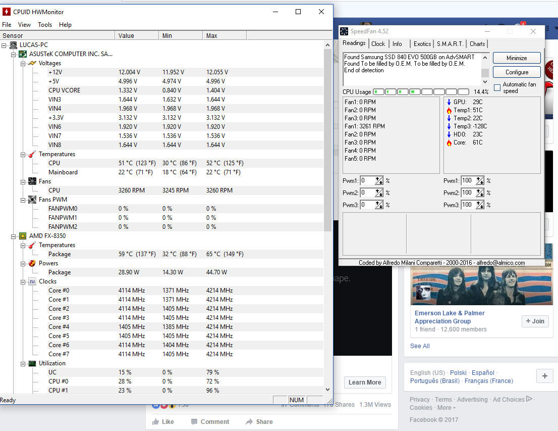

The top part of HWMonitor is missing do it again for us but this time make sure that you scroll to the top of the page.
Posted 28 January 2017 - 10:06 AM
Just as a point of reference I have added the "low temp" screenshot even though HWMonitor is not scrolled all the way to the top, as these two screenshots were taken no more than 5 minutes apart but look at the difference in temperature.

Only thing that I am seeing is that the vcore at max is too high, anything higher than 1.375V is overclocking the CPU.
check in the BIOS to make sure that the thermal shutdown temp has not been disabled or increased to such a high level that the CPU can fry.
Has this been done.
Can you tell us what cooler is being used with FX8350 and has it been checked to make sure that it is both sitting properly and secure.
NB: Note the high CPU activity level for a computer that is not under any load, any chance that your friend has OCd the CPU too far.

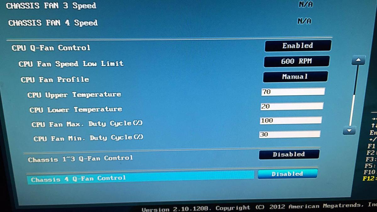

I actually cannot find where within the BIOS the option for the shut down temperature is.
His motherboard is the AMD SABERTOOTH 990FX

That is but a part of it, download and read the manual which you can obtain from here the manual tells you how to set up the board to get the best cooling settings etc.
