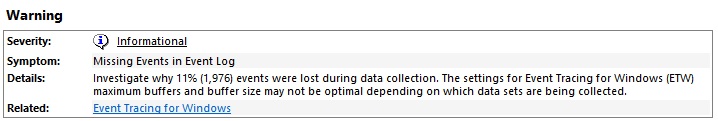

i was told to try running a report using the integrated performance monitor and so i did. i managed to fix a few issues with the help of google etc, now the issue shifted to another one, and games and browser still crash in the same ways. Now the performance monitor suggests that i need to optimize my maximum buffers and buffer size. What is this? And how do i do this? is it a realistic problem to my issue? Maybe some of my hardware are not compatible? maybe i am missing something in my build? any suggestions will be deeply appreciated!

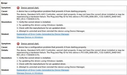

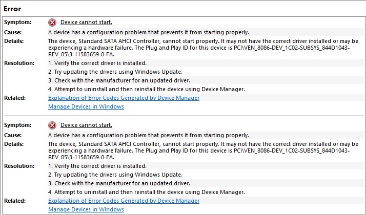

1st report:
Basically it was saying : The device, Standard SATA AHCI Controller, cannot start properly.
i managed to fix this error by downloading an appropriate driver from my motherboard's website.

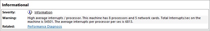

second thing was saying: "High average interrupts / processor. This machine has 8 processors and 5 network cards. Total Interrupts/sec on the machine is 54501. The average interrupts per processor per sec is 6813."
now i am not sure what this implies exactly but the message did not appear anymore after updating the driver so i assumed it was fixed...
2nd report:
