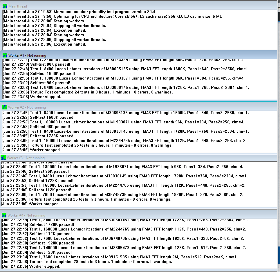

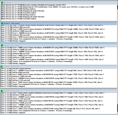

Finally found time to start this. Hard drive tests passed. Running CPU now.
kouper
kouper
  • 17 posts
CPU tests
