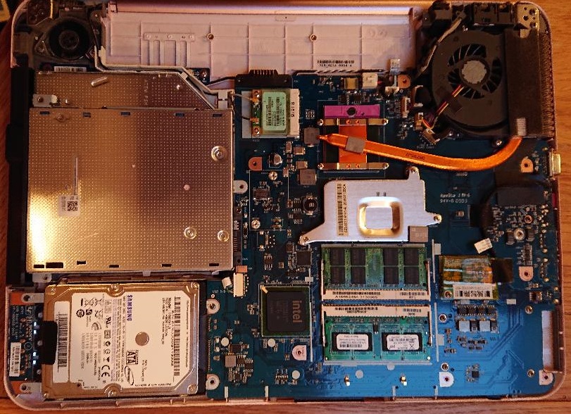

Now at last today, I had a bit of quiet time to myself and decided to try and follow your instructions to perform a 'power cycle'. I have opened up the laptop, but do not know how to remove the CMOS battery and the RAM and (though I am embarrassed to admit it) am not even 100% sure whereabouts they are, so am attaching a picture of the interior to see if would be kind enough to give me some guidance.
I guess the CMOS battery must be the little thing at the top left of the screen, so can probably get that out somehow. The RAM is more difficult though. I know what the RAM in a desktop computer looks like, but this looks different. I guess it must be somewhere near the bottom of the picture, but have no idea exactly which it is, or how to remove it.
Thanks in advance for any help you can give me. I hope you and all your family are well, especially your grandson.

The RAM is easy enough as it can be seen in your picture, gently release the springs at each side of the RAM and then slide it out,  the CMOS battery is on the other side of the MB and needs the top of the case to come of to get at it/them, slightly different to the standard CR2032 type, see the attachment below and the video for how to get to the CMOS battery, the only video that I could find so forgive the jack replacement information. video - CMOS battery Crucial RAM upgrade video

This is probably a really stupid question to you.....but of the two items/layers in the picture below, which is the RAM? And what is the other one? I want to make absolutely sure before I attempt to remove anything.
EDIT I suppose they could both be RAM. One of them says 'warrantty void if removed though. And they both look so different.....so I am completely confused! :(

Used your previous picture, see attachment, the two arrows show the spring loaded clips that hold the RAM in place, gently ease them sideways at the top so that the RAM will slide out.

NB: Took a look at the earlier attachment regarding the RAM, can`t be 100% certain I`m afraid but there is what looks like a BIOS speaker in the pic which has been outlined.
