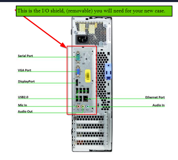

do you have a complete computer?   If yes, you need the rear I.O shield, example, first picture.  Yours may only have a DVI and Displayport.

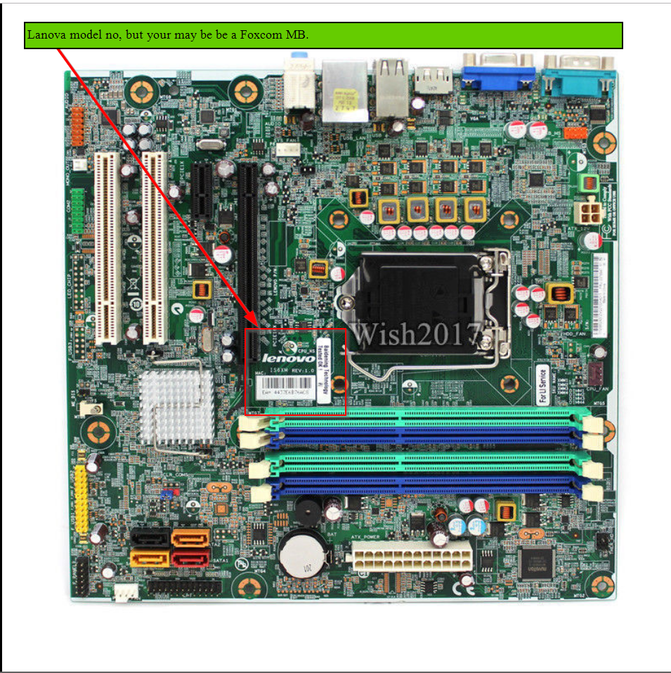

If you only have the MB, example, second picture.
