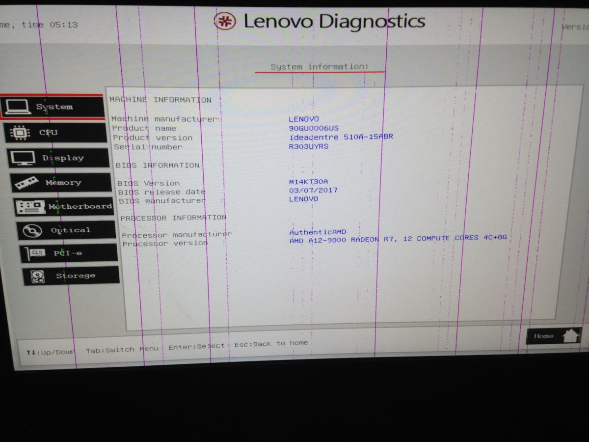

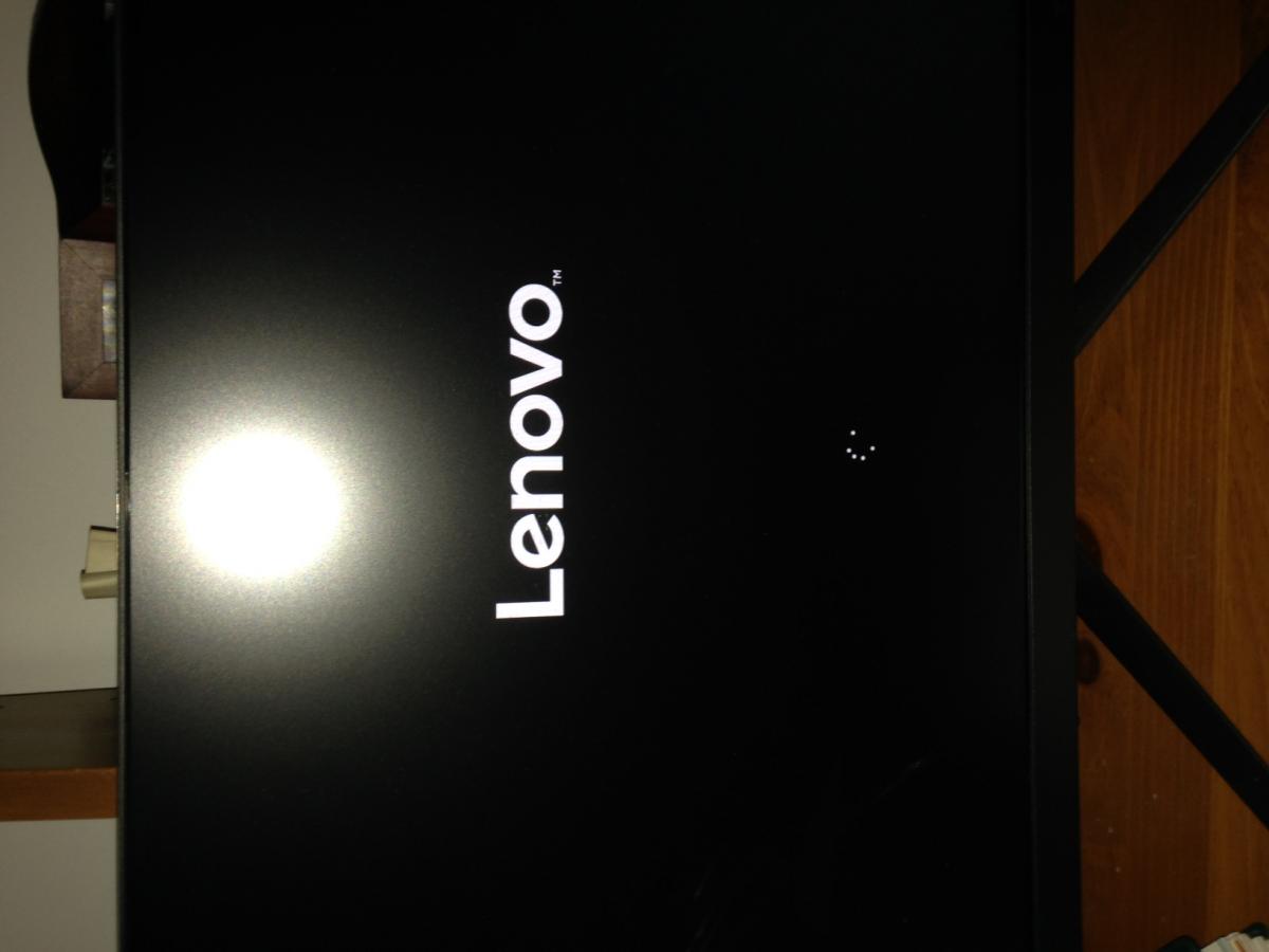

Computer gets stuck on Lenovo screen, I was able to get to the diagnostic utility by hitting a function key, I did get display for boot options but did not change anything there yet (i attached a pic of the screen to show glitchy display as I was in the diagnostic tool)

image 1.JPG image 2.JPG I'll try that again and added the lenovo screen where the pc gets stuck
  • 24,748 posts
That looks to be hardware related.
