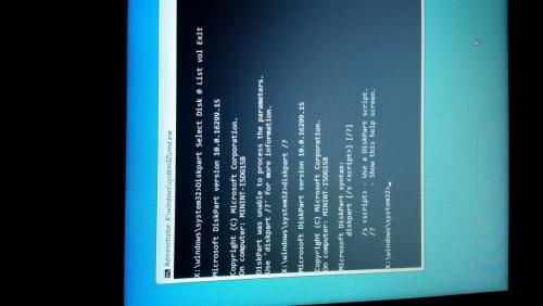

CEF
CEF
  • 31 posts
I hope this is correct; I did type in "diskpart /?" As it suggested (after typing what you told me to)
Sorry the attachment shows up sideways.
JSntgRvr
JSntgRvr
    Global Moderator
  • 11,539 posts
No. Each line is a command. Press Enter after each command.

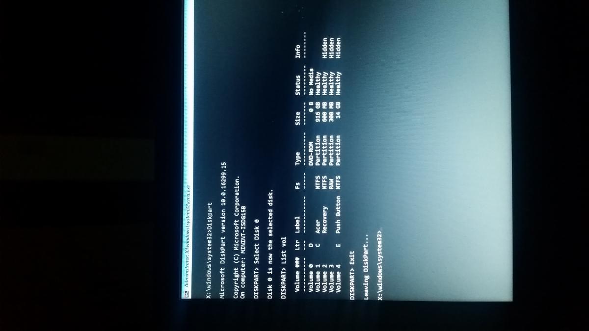

CEF
CEF
  • 31 posts
JSntgRvr
JSntgRvr
    Global Moderator
  • 11,539 posts
As you can see the Volume 3 has lost its format. That is the reason it appears as RAW.
Lets try to fix that. Boot to the RE Command prompt. At the prompt type the following and press Enter after each command (The dialog between parenthesis must be received before continue to the next command):
Diskpart
Sel Disk 0 (Disk 0 is now the selected disk.)
List vol
Sel vol 3 (Volume 3 is the selected volume)
Format fs=FAT32 quick
Assign letter=M
Exit
MD M:\EFI\Microsoft\Boot
cd /d M:\efi\microsoft\boot (The pompt should change to M:\efi\microsoft\boot)
Bootrec /Fixboot (If an error is returned, continue with the rest)
bcdboot C:\windows /s M: /f ALL
If successful, restart the computer.
If the computer wont boot, then lets repeat the previous commannd:
Boot to the RE Command prompt. A the prompt type the following and press Enter:
Diskpart
Select Disk 0    [That is Select Disk Zero]
List vol
Exit
Take a picture of that screen and attach it in your next reply.

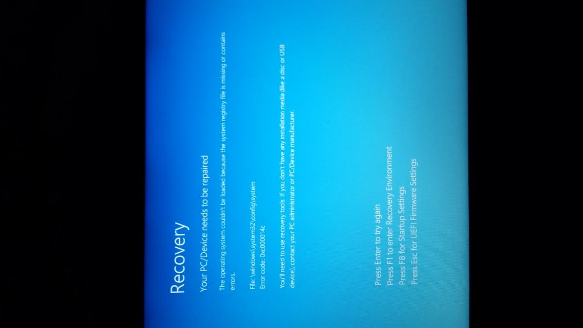

CEF
CEF
  • 31 posts
So after following those instructions and restarting the computer it came up to this screen. The only place I can go is the UEFI Firmware Settings; any other option goes to the Acer logo screen, then right back to this blue screen.
