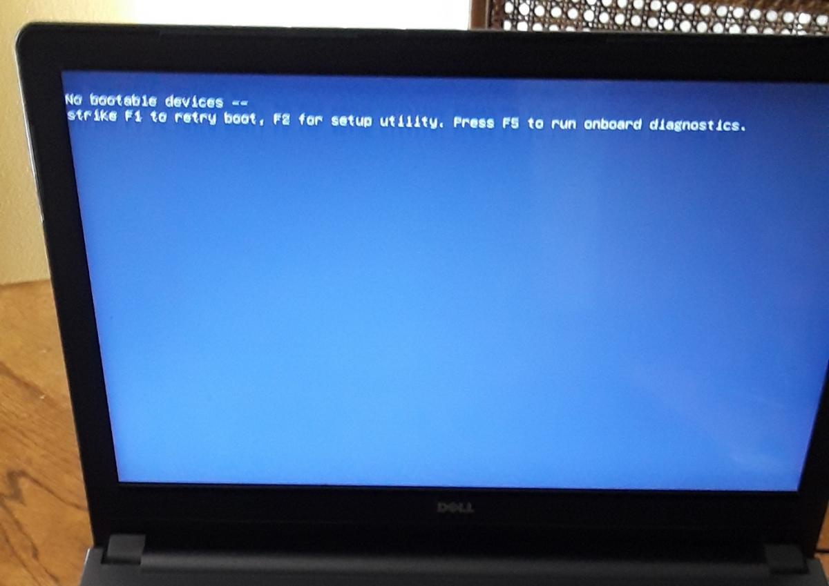

Dell Windows 10 - No bootable devices?

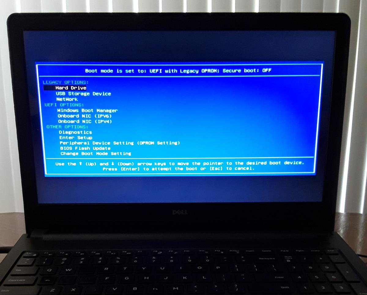

This is what my laptop shows:
I selected USB Storage Device, Onboard NIC (IPV6) and Onboard NIC (IPV4). All three options, I received the message: Selected boot device failed. Press any key to reboot the system.
What do I do now?
  • 24,716 posts
Legacy option should be USB Storage Device first in the list.
Just a fyi, unless your computer has previously been set up so that it can be accessed by a network you should not have any NIC device/s selected as a boot device in either of the BIOS options, this the reason why you got the Selected boot device failed. Press any key to reboot the system. for two of the three options you had selected.

Hi phillpower2,
I don't understand your statement. Are you saying that USB Storage Device should be listed above Hard Drive? If so, how do I move it?
Also, my laptop has gotten progressively worse. I haven't been able to go pass the Lock Screen today.
  • 24,716 posts
Hello Sugartooth,
The USB device needs to above the HDD as when the computer restarts it will boot using the software on the USB device itself and not from the computers HDD.
The bottom screenshot in your reply #33 tells you how to change the boot preferences, see beneath the line at the bottom, use the arrow keys to move the pointer info.

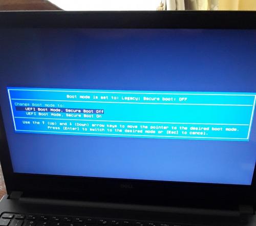

Hi phillpower2,
I'm not able to change the boot preferences. When I selected Change Boot Mode Setting, this is what I got:
When I tried to Escape, this is what happened:
I tried Press F5 to run onboard diagnostics. All it told me was Testing completed. One or more errors were detected.
We were trying to test the RAM, correct? What if I just purchase 2 new matching RAMS? Would that solve the problem? If so, what brand RAM do I purchase? Or is the laptop not salvageable?
  • 24,716 posts
Hello Sugartooth,
Yes we are trying to test the RAM.
Purchasing anything is always a last resort and purchasing a new notebook is not even a consideration tbh.
Have you tried putting the USB drive before the HDD in UEFI BIOS and then changing from UEFI to Legacy mode, long shot but we need to try everything.
Something else that can make a difference is having the thumbdrive in a USB 3.0 port so can I ask that you make sure that you use one of the USB 2.0 ports and that you do not have any other thumbdrives plugged in while you test, a USB mouse would be ok if you happen to use one.
If we cannot get Memtest to run from the thumbdrive we have two options, try running the basic Windows memory test and checking the Memtest software on the thumbdrive.

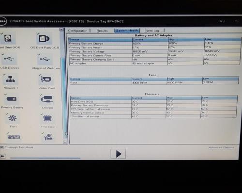

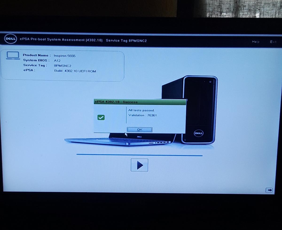

I wanted to mention that when I went to turn my laptop off, the Dell ePSA Pre-boot System Assessment came on. It ran a quick test and said everything was okay ( :no:). Then it asked if I wanted to run a more thorough test and I thought, why not? It should finish after 2 hours. I'll let you know the results.
#45
Sugartooth
Sugartooth
  • 881 posts
The test finished, but not helpful.
