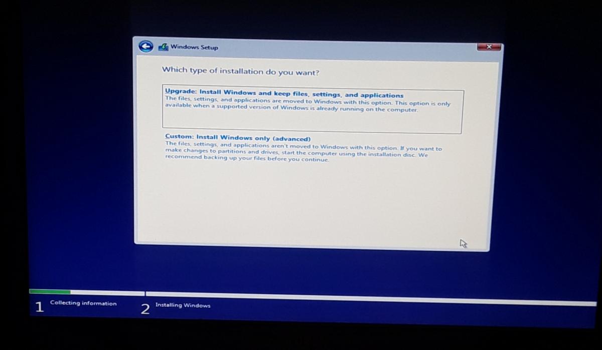

I chose the first option: Upgrade. That was not a good choice as it said to remove the Windows 10 installation media and restart the computer. After waiting for another day and night, I selected the second option: Custom. I wasn't sure whether to remove the Windows 10 installation media, so I left the USB plugged in.
Now, I'm stuck on this screen with the hourglass and the screen is frozen. It's been 3 hours now.
If the hourglass changes back into a mouse cursor, which option should I choose for Where do you want to install Windows? And what about the Refresh, Delete, Format, New, Load driver, and Extend? Would I click on any of those? I will give it another 24 hours before I give up on trying to install Windows.

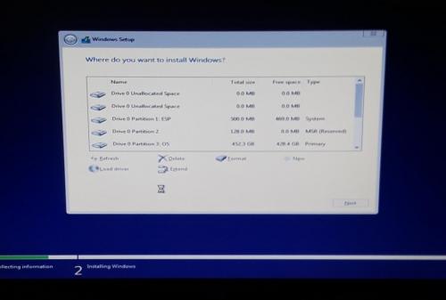

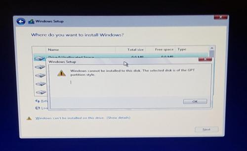

If possible the Primary partition that has the OS on it needs to be formatted (Pic 3 in reply #49) and then Windows clean installed to the same partition.

I selected the Primary partition and clicked on Format. After waiting an hour and a half for the hourglass to turn into a cursor, I clicked on Primary again and the same pop up appeared regarding GPT. What should we try now?

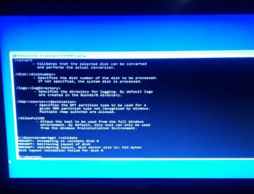

I tried using the MBR2GPT.EXE from the Microsoft tutorial. This is the result

Apologies, I should have been more specific and should have said at the link to follow the "Reformatting the drive using a different partition style info" the info in your reply #54 suggests that only a single partition was formatted and not the full drive which is what is needed.

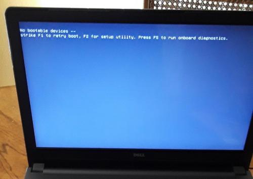

I've tried for 2 days to get into Automatic Repair mode so that I can reach Windows Setup (in order to format the entire drive), but it won't do it. The way I'd been reaching it was by turning my laptop on and off, 3 times, in rapid succession. Now when I do that, it goes back to this screen.

The original Windows OS has been deleted which means that there is no Recovery Environment present and so no Automatic Repair option.
The screenshot above means that the BIOS is looking for an OS to load or install.

I can't install Windows. There was a pop up window that read: This partition is too small. Make the size of the partition at least 9772 MB or select another partition.  I tried to by clicking on New, but as you can see, it reads: The size must be at most 0 MB.

Bottom line it looks like the system is a UEFI system setup to boot Legacy with a MBR HDD but Windows Setup says the disk if setup for GPT, not MBR.
So the right thing to do is change it back to UEFI from Legacy, with secure boot on or off (both should work) then do the following:
