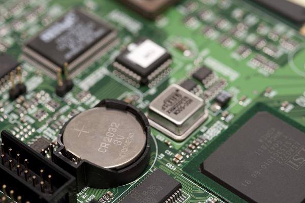

yes you need the little coin battery. I don't know much about the specifics of what your building, but the bios  and battery work pretty much the same everywhere.
If the CMOS battery in your computer or laptop dies, the machine will be unable to remember its hardware settings when it is powered up. It is likely to cause problems with the day-to-day use of your system
You may need to enter the bios of your system and reset the settings and save for the system to work properly.
For more details:  https://en.wikipedia...ile_BIOS_memory

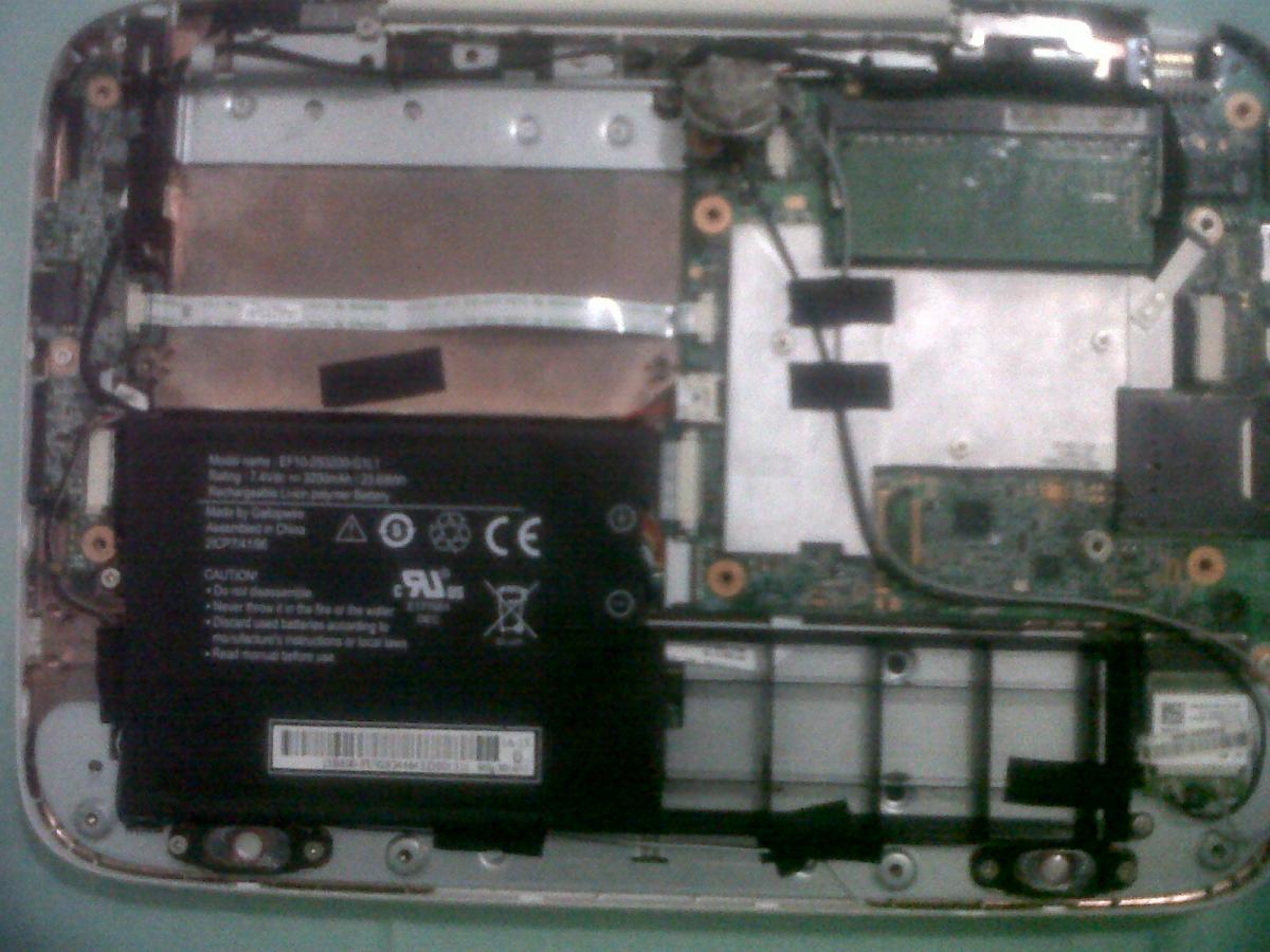

I went to talk to him... it turns out that the "side board" wasn't damaged. The pulled out the one from his very own laptop and placed it on my laptop. Also he took my "side board" (Which I thought was dead) and placed it into his laptop and it works.
Good thing I didn't even try to argue today.
Well, the only thing left to test is the big battery.
Also, I think these laptops come with a CR2016 coin battery, I'm unsure if that is the correct model name, I've seen them and they're thinner than the CR2032.
I uploaded 2 screenshots. The board still has no hard drive, but that's not a critical boot component... right?
And it's missing some screws, I did that on purpose. For faster disarming.
The photo quality is... crappy, I know. It's nighttime... a BlackBerry 8520 camera... so... :yes:

When you say ''big battery'' do you mean one of these Polymer Battery, - 2 cell battery 25 Wh (3400mAh), - 3 cell battery 37 Wh (3400mAh)?
A possible user manual, > https://www.manualsl...l?page=5#manual
Can't find info on which CMOS battery size, so you may have to purchase both and see which fits.

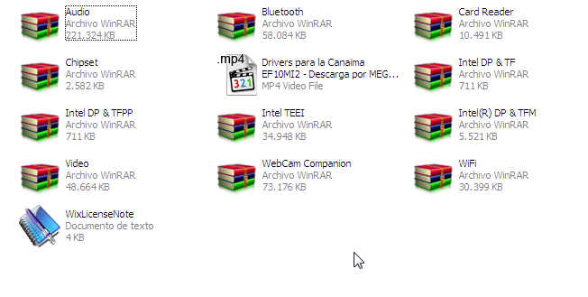

Have you sourced/got the MB drivers?

And yes, I also got the drivers, I just need the d*mn thing to power on. :smashcomp:

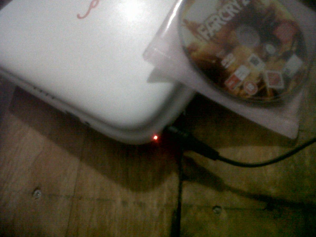

When I press the power on button nothing happens, not even a LED, nothing.
When I connect the ac adapter it should activate the "charging LED", which is red.
With the ac adapter connected, if I press the power on button nothing happens.

When you plug in and turn on the AC adapter, the battery indicator light should be blue,, charged, or orange, low batter.
When you press the power on button, the indicator next to it should be blue.
Will wait for your test results.

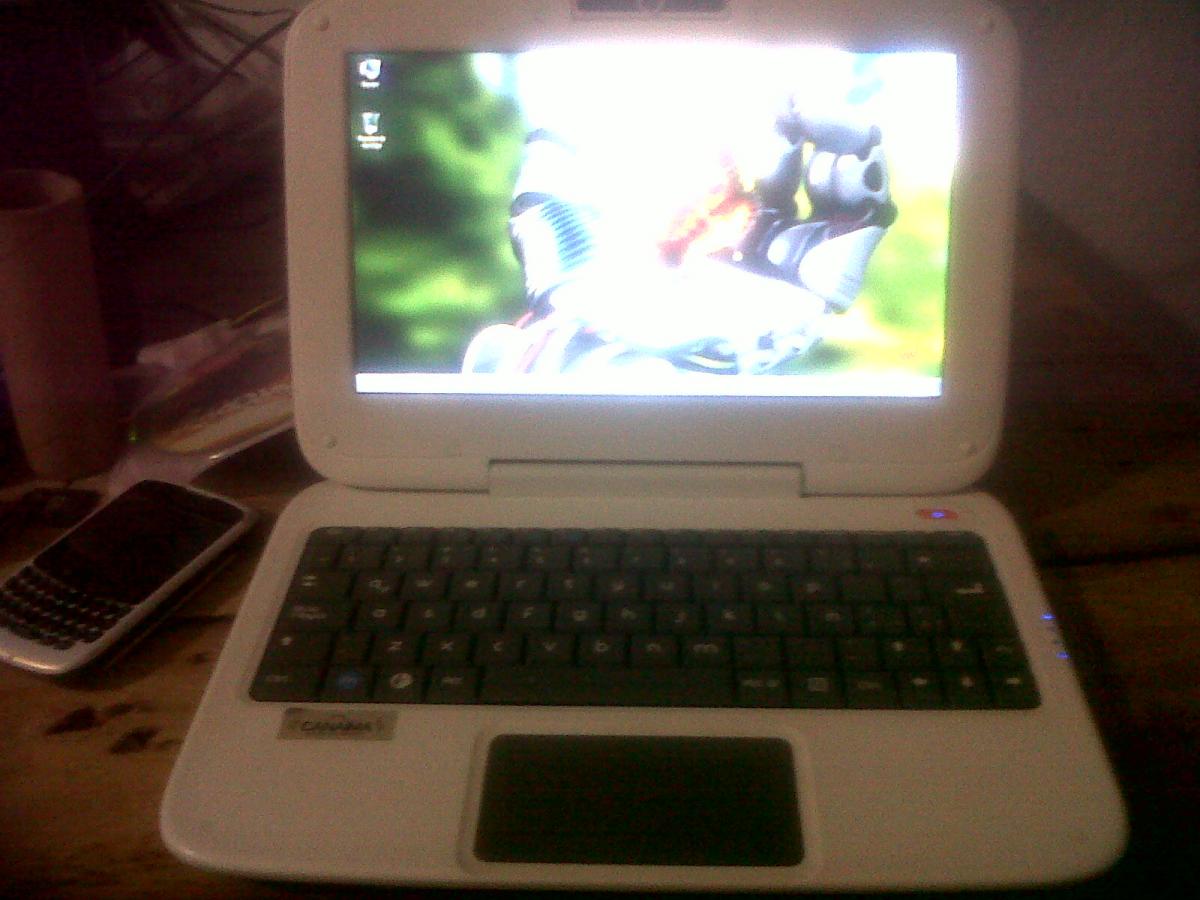

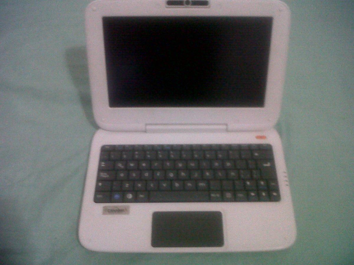

Photos:
Sorry for the mess

I spoke too soon. The laptop was working at 100%, everything good.
The charger I use is not a charger designed for this model, it works with my other laptop which is from the same manufacturer.
Like 30mins after I took these 2 photos, the laptop fried. The speakers, the battery pack and who knows what else. It smells bad. :(
I'm kinda sure it was the charger who did this. At the tech guys place, he placed a hard drive and installed Windows 7, nicely, np problems. When I arrived home, I powered it on, watched some videos, then plugged in the charger... now it's dead.
I spent all my savings on this thing.
