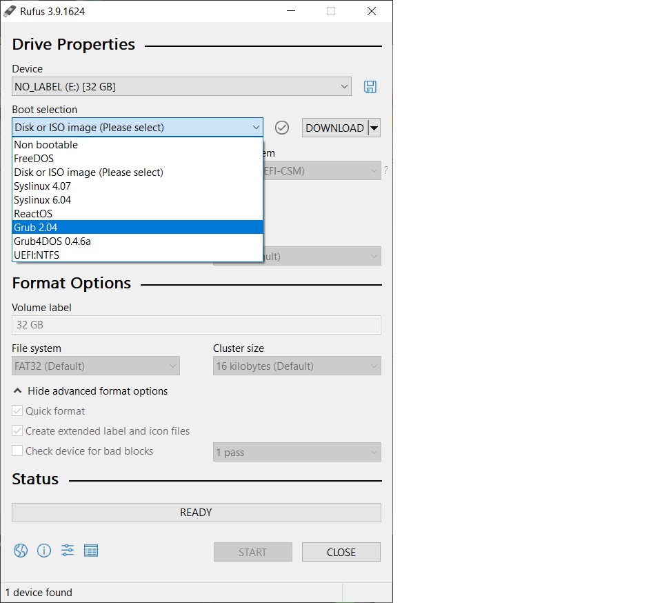

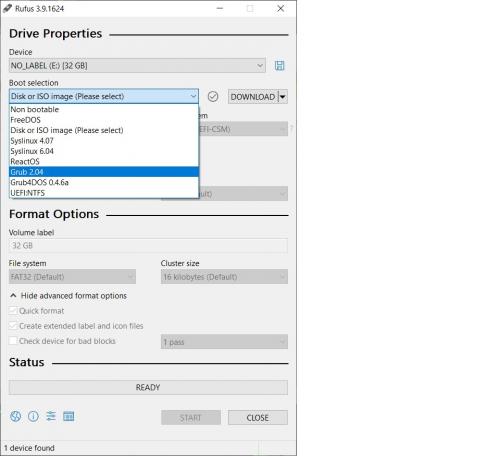

They are really old, as am I.  2 GB.  Need at least 4.  New USB came today.  I need to choose one of the following and have no idea what to pick.  The guides are really helpful until after you download and then they just tell you to select.  Which one do I select?  I am in need of your guidance, please.

  • 24,338 posts
Sorry but from afar it is difficult to follow where you are up to I`m afraid,
Start afresh but instead use Puppy Linux which you can download from here Slackware64 14.1 is the one you want.

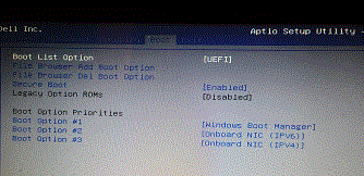

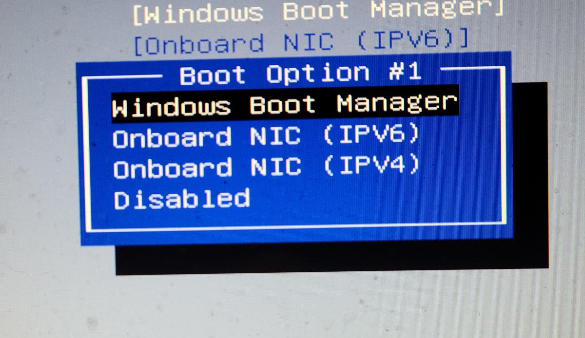

Sorry, hard day at work.  My Bios is not like that of Puppy.  I took pictures.  Not sure which is my USB.  Don't want to mess up!  I could use your guidance, please.

  • 24,338 posts
No worries, the tutorial shows the original Legacy BIOS whereas your computer has the more modern UEFI, I do have this covered in another version but will spare you the step by step, in your first pic you can see the entry Secure Boot which is enabled, the Legacy Boot needs to be enabled and the Secure Boot disabled for the computer to be able to boot from the USB device, Legacy BIOS should give you different options, we are looking for USB device which can sometimes be described/listed as external hard drive depending on the brand of BIOS.

  • 40 posts
I enabled Legacy and disabled Secure Boot.  It made no difference in my options.  I don't know if Onboard NIC IPV6 or IPV4 is my USB or not.

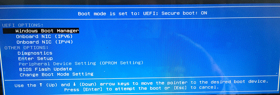

  • 24,338 posts
Alternative approach, leave the USB device in the port then restart the notebook.
Keep tapping F12 when you start the notebook to see if you get the one time boot option which will hopefully allow you to then boot from the thumb drive.

  • 40 posts
Here is what I get when tapping F12:
