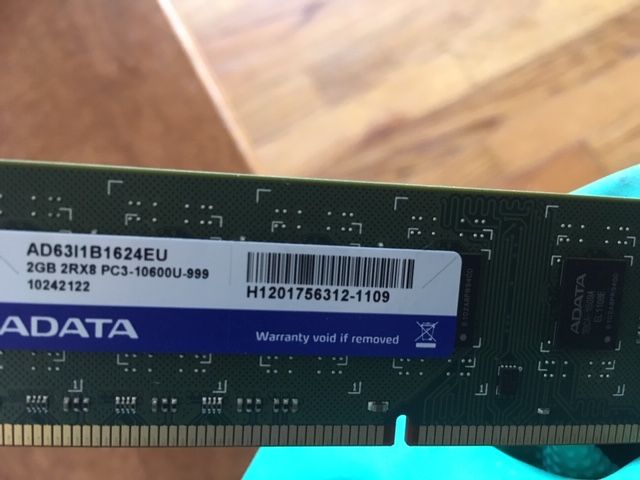

I'm trying to assist a friend upgrade her RAM from 2GB to 4GB due to her just upgrading to Windows 10. Her PC is a rebuilt machine from a local retailer Micro Center.  I had her run Crucial's Memory Match scan (https://www.crucial....l-advisor-trust) and it returned a response that it could not identify a match to her system.

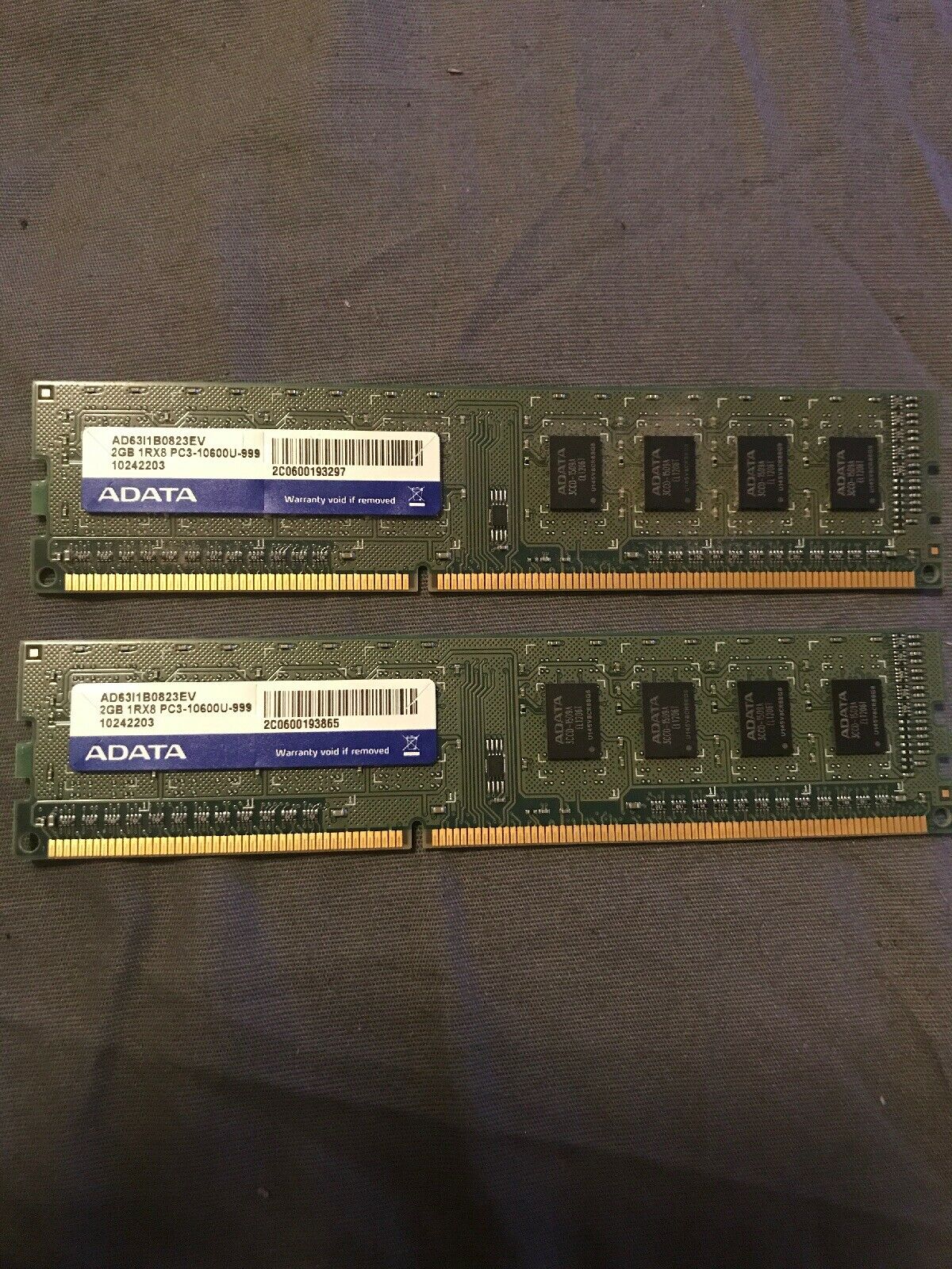

Her picture of her current RAM (Alex memory) is attached as well as a pair of 2GB modules on ebay.  I'm hoping the difference in numbers (2RX8 vs. 1RX8) refers to transfer rate / clock speed / latency and that the EBAy memory will offer a usable upgrade solution.
Her single stick of memory is from ADATA and is labeled as follows:  Adata (2x2gb) 2RX8 PC3-10600u-99
The EBAY Memory is 2 sticks from ADATA and is as labled follows:   Adata (2x2gb) 1RX8 PC3-10600u-99
Thank you in advance for any assistance you can offer.

1Rx8 means it is a single-rank module and 2Rx8 means it is a dual-rank module module. Rank is a data block which is 64 bits wide without Error Correction Code (ECC) created using some, or all of the memory chips on a module. The x8 in them specifies the number of banks in the memory module. Higher the number of banks, the fewer the chips in the memory module, the better the reliability and power consumption.
Compatibility is generally not an issue in most cases. But you should go through the motherboard manufacturer's guide of supported RAM modules just to make sure if they are compatible or not.

"I'm hoping the difference in numbers (2RX8 vs. 1RX8) refers to transfer rate / clock speed / latency "   NO.
Marking 1R means 1 rank of memory in one RAM module/ stick. Rank is a set of memory chips (8 soldered together) working as a one group.
Look at your first image, just above the gold fingers on the left, you can see the 8 solder points for the 8 chips. on the right, there are no soldered on chips, the other 8 chips can be seen on the reverse side of the stick, and the system will see the stick as 2GB of installed RAM. this will run in duel channel mode.
 Marking 2R means 2 ranks of memory in one RAM module/ stick.
Look at your second image, there are chips soldered on the left and right above the gold fingers and non on the reverse side.
​the system will still see  2GB of installed memory for each stick x 2 = 4GB of installed RAM and will run in single channel mode
Both the existing and replacement run at 1.5 volts. So you are good to go.
