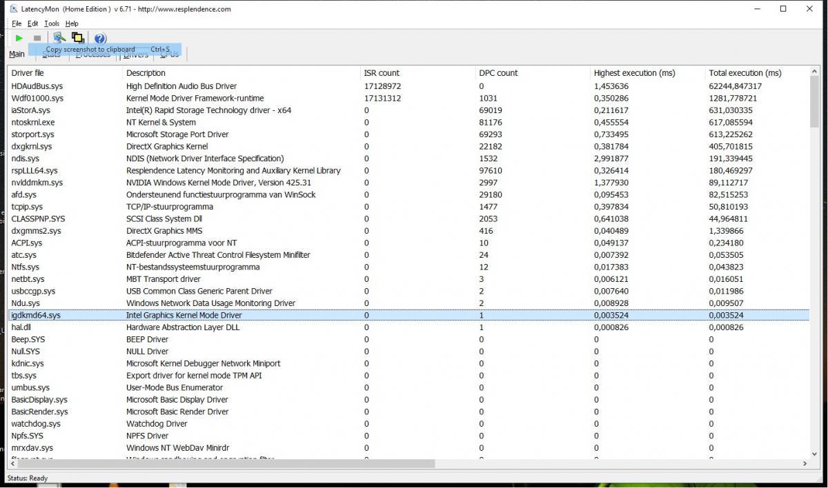

I remember no by reading the log from latencymon, I did update the drivers intel and nvidia using the website of intel and nvidia and not acer, as acer did not give any update. I hope this is not a issue?
log latencymon
CONCLUSION
Your system appears to be having trouble handling real-time audio and other tasks. You are likely to experience buffer underruns appearing as drop outs, clicks or pops. One or more DPC routines that belong to a driver running in your system appear to be executing for too long. Also one or more ISR routines that belong to a driver running in your system appear to be executing for too long. At least one detected problem appears to be network related. In case you are using a WLAN adapter, try disabling it to get better results. One problem may be related to power management, disable CPU throttling settings in Control Panel and BIOS setup. Check for BIOS updates.
LatencyMon has been analyzing your system for  0:02:24  (h:mm:ss) on all processors.
SYSTEM INFORMATION
Computer name:                                        LAPTOP-ACER
OS version:                                           Windows 10 , 10.0, build: 18363 (x64)
Hardware:                                             Aspire E5-574G, Acer, Zoro_SL
CPU:                                                  GenuineIntel Intel® Core™ i5-6200U CPU @ 2.30GHz
RAM:                                                  8058 MB total
CPU SPEED
Reported CPU speed:                                   240 MHz
WARNING: the CPU speed that was measured is only a fraction of the CPU speed reported. Your CPUs may be throttled back due to variable speed settings and thermal issues. It is suggested that you run a utility which reports your actual CPU frequency and temperature.
Highest measured interrupt to process latency (µs):   2640,60
Average measured interrupt to process latency (µs):   11,284208
Highest measured interrupt to DPC latency (µs):       2628,20
Average measured interrupt to DPC latency (µs):       5,736160
 REPORTED ISRs
Highest ISR routine execution time (µs):              1453,635833
Driver with highest ISR routine execution time:       HDAudBus.sys - High Definition Audio Bus Driver, Microsoft Corporation
Highest reported total ISR routine time (%):          10,804071
Driver with highest ISR total time:                   HDAudBus.sys - High Definition Audio Bus Driver, Microsoft Corporation
Total time spent in ISRs (%)                          11,016237
ISR count (execution time <250 µs):                   34260001
ISR count (execution time 500-999 µs):                279
ISR count (execution time 1000-1999 µs):              5
ISR count (execution time 2000-3999 µs):              0
REPORTED DPCs
Highest DPC routine execution time (µs):              2991,876667
Driver with highest DPC routine execution time:       ndis.sys - NDIS (Network Driver Interface Specification), Microsoft Corporation
Highest reported total DPC routine time (%):          0,109530
Driver with highest DPC total execution time:         iaStorA.sys - Intel® Rapid Storage Technology driver - x64, Intel Corporation
Total time spent in DPCs (%)                          0,515064
DPC count (execution time <250 µs):                   377599
DPC count (execution time 500-999 µs):                405
DPC count (execution time 1000-1999 µs):              14
DPC count (execution time 2000-3999 µs):              3
 REPORTED HARD PAGEFAULTS
Process with highest pagefault count:                 bdservicehost.exe
Total number of hard pagefaults                       21019
Hard pagefault count of hardest hit process:          8564
Number of processes hit:                              62
 PER CPU DATA
CPU 0 Interrupt cycle time (s):                       71,573401
CPU 0 ISR highest execution time (µs):                1453,635833
CPU 0 ISR total execution time (s):                   63,463042
CPU 0 ISR count:                                      34259003
CPU 0 DPC highest execution time (µs):                2991,876667
CPU 0 DPC total execution time (s):                   0,896396
CPU 0 DPC count:                                      156296
CPU 1 Interrupt cycle time (s):                       3,086312
CPU 1 ISR highest execution time (µs):                16,203333
CPU 1 ISR total execution time (s):                   0,000380
CPU 1 ISR count:                                      253
CPU 1 DPC highest execution time (µs):                733,4950
CPU 1 DPC total execution time (s):                   1,122147
CPU 1 DPC count:                                      125385
CPU 2 Interrupt cycle time (s):                       2,714395
CPU 2 ISR highest execution time (µs):                17,109167
CPU 2 ISR total execution time (s):                   0,000165
CPU 2 ISR count:                                      47
CPU 2 DPC highest execution time (µs):                666,1550
CPU 2 DPC total execution time (s):                   0,727139
CPU 2 DPC count:                                      81282
CPU 3 Interrupt cycle time (s):                       0,840506
CPU 3 ISR highest execution time (µs):                43,955833
CPU 3 ISR total execution time (s):                   0,003597
CPU 3 ISR count:                                      982
CPU 3 DPC highest execution time (µs):                1377,930
CPU 3 DPC total execution time (s):                   0,221728
CPU 3 DPC count:                                      15058

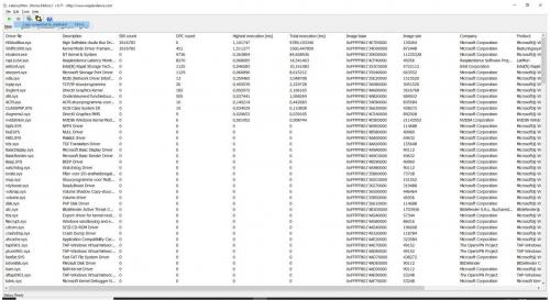

I only had malwarebyte rootkit on that was scanning, nothing else. but this tiem I disconnected all devices, internet:
CONCLUSION
Your system seems to be having difficulty handling real-time audio and other tasks. You may experience drop outs, clicks or pops due to buffer underruns. One or more DPC routines that belong to a driver running in your system appear to be executing for too long. Also one or more ISR routines that belong to a driver running in your system appear to be executing for too long. At least one detected problem appears to be network related. In case you are using a WLAN adapter, try disabling it to get better results. One problem may be related to power management, disable CPU throttling settings in Control Panel and BIOS setup. Check for BIOS updates.
LatencyMon has been analyzing your system for  0:00:25  (h:mm:ss) on all processors.
SYSTEM INFORMATION
RAM:                                                  8058 MB total
CPU SPEED
Highest measured interrupt to process latency (µs):   432,50
Average measured interrupt to process latency (µs):   15,383365
Highest measured interrupt to DPC latency (µs):       428,60
Average measured interrupt to DPC latency (µs):       8,754833
 REPORTED ISRs
Highest ISR routine execution time (µs):              1101,746667
Highest reported total ISR routine time (%):          9,771214
Total time spent in ISRs (%)                          11,284062
ISR count (execution time <250 µs):                   5233507
ISR count (execution time 500-999 µs):                55
ISR count (execution time 1000-1999 µs):              3
REPORTED DPCs
Highest DPC routine execution time (µs):              1511,276667
Driver with highest DPC routine execution time:       Wdf01000.sys - Kernel Mode Driver Framework-runtime, Microsoft Corporation
Highest reported total DPC routine time (%):          0,058275
Driver with highest DPC total execution time:         ntoskrnl.exe - NT Kernel & System, Microsoft Corporation
Total time spent in DPCs (%)                          0,171582
DPC count (execution time <250 µs):                   21452
DPC count (execution time 500-999 µs):                19
DPC count (execution time 2000-3999 µs):              0
Total number of hard pagefaults                       9
Hard pagefault count of hardest hit process:          6
  • 24,441 posts
When MBAR is doing a scan, BitDefender will watch over its shoulder and check each file that MBAR looks at so that's why it appeared that BitDefender was also doing a scan.
From the latest Lat Mon scan it looks like HDAudBus.sys is the culprit. That's a Windows driver so probably not at fault.  I found a similar problem where they did everything trying to solve the problem and after 5 pages they updated the BIOS and that fixed it.  https://www.sysnativ...g-noises.22016/
You have a rather old BIOS so I would go to ACER support and put in the serial number of your PC and see if they have a new BIOS for you.  I tried to find one but ACER didn't sell your model in the US so their support doesn't offer any drivers.  I did find a similar ACER model that has a new BIOS and several new Intel drivers:
https://www.acer.com...roduct/7382?b=1
so hopefully they will have something for yours.  Apparently you need at least:
one from 2018/05/25
You currently have  25/05/2017
Also I see fontdrvhost.exe on the list of pagefaults.  This usually means there is some corruption in the font cache.  See if you can follow the instructions here:
