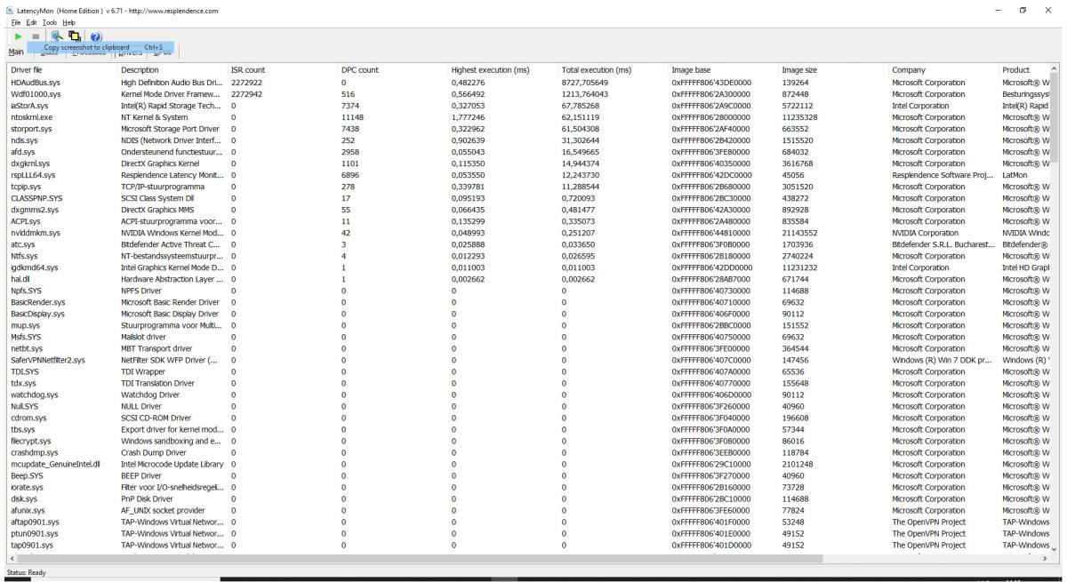

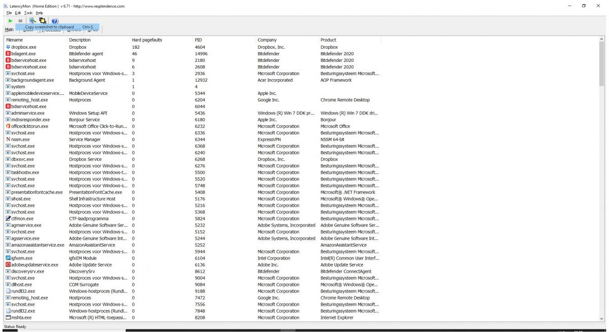

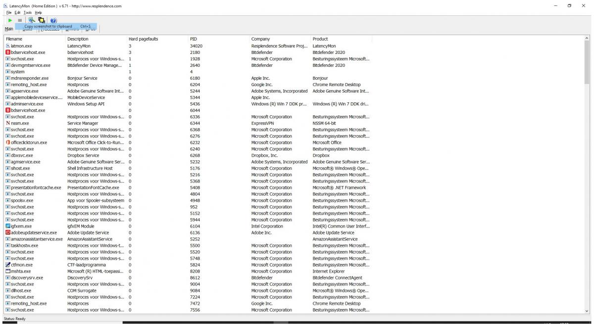

#50
  • 24,441 posts
That looks like it cut the highest Execution time by more than 1/2 so we are on the right track.  What does the driver tab say for version and date (on the Realtek HD Audio) now?
See if you can either shut down SearchIndexer or modify it to just look at file names in a limited part of the Hard drive:
https://www.howtogee...-is-it-running/
Also see if you can get a new Intel RST:  You have:
Intel® Rapid Storage Technology Version: 14.8.16.1063
Go to this page:
https://downloadcent...r?product=55005
This is Version: 15.9.8.1050 which is a step up from what you have tho not the latest available.
Click on the Download button under SetupRST.exe
Save and then right click and Run As Admin.  See if it will install.
Process Explorer log?
Also a new lat mon if you were able to stop or modify searchindexer and/or install a new IntelRST

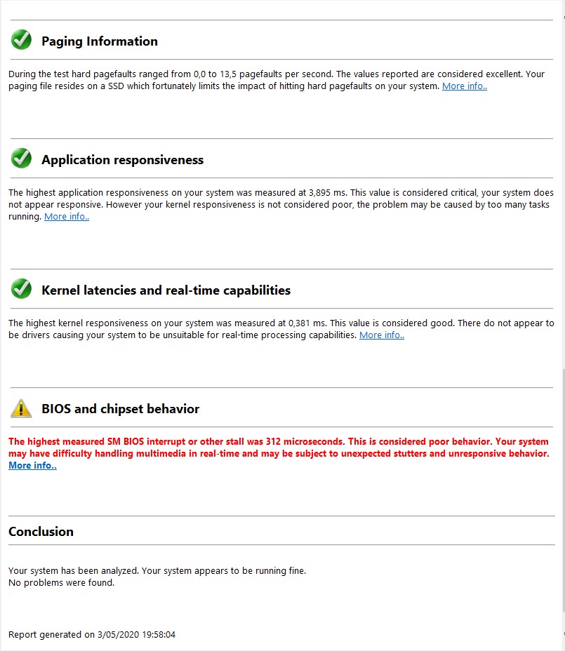

disabled Wsearch.
CONCLUSION
Your system seems to be having difficulty handling real-time audio and other tasks. You may experience drop outs, clicks or pops due to buffer underruns. One or more DPC routines that belong to a driver running in your system appear to be executing for too long. At least one detected problem appears to be network related. In case you are using a WLAN adapter, try disabling it to get better results. One problem may be related to power management, disable CPU throttling settings in Control Panel and BIOS setup. Check for BIOS updates.

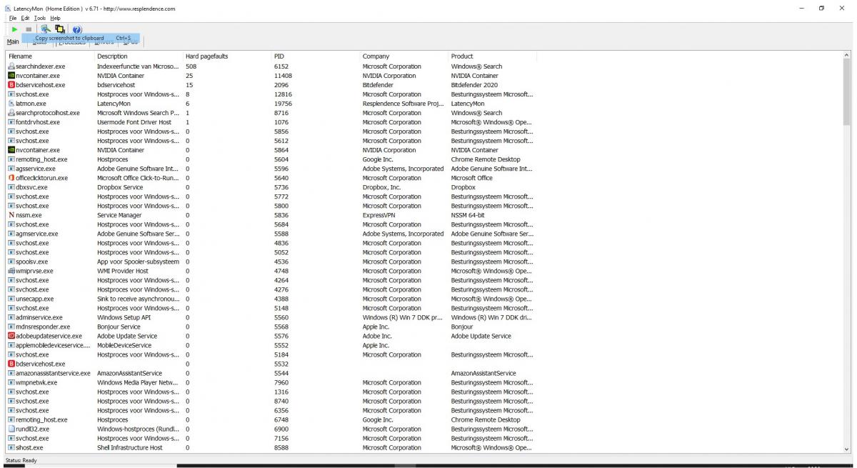

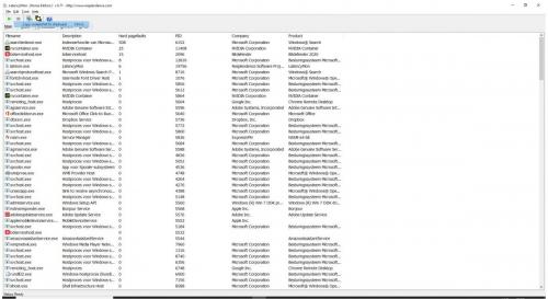

#54
  • 24,441 posts
Didn't really have much of an effect on Interrupts unfortunately but PageFaults are much improved.  This time the worst culprit is the network adapter.  Can you disable or unplug the internet while running lat mon & process explorer?

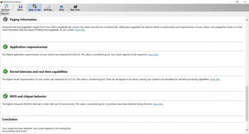

whyso slow print screen

disconnected internet cable. logs :
CONCLUSION
LatencyMon has been analyzing your system for  0:00:23  (h:mm:ss) on all processors.
SYSTEM INFORMATION
Computer name:                                        LAPTOP-ACER
OS version:                                           Windows 10 , 10.0, build: 18363 (x64)
Hardware:                                             Aspire E5-574G, Acer, Zoro_SL
CPU:                                                  GenuineIntel Intel® Core™ i5-6200U CPU @ 2.30GHz
Logical processors:                                   4
RAM:                                                  8058 MB total
CPU SPEED
Reported CPU speed:                                   240 MHz
WARNING: the CPU speed that was measured is only a fraction of the CPU speed reported. Your CPUs may be throttled back due to variable speed settings and thermal issues. It is suggested that you run a utility which reports your actual CPU frequency and temperature.
Highest measured interrupt to process latency (µs):   392,50
Average measured interrupt to process latency (µs):   11,580333
Highest measured interrupt to DPC latency (µs):       383,10
Average measured interrupt to DPC latency (µs):       5,200063
 REPORTED ISRs
Highest ISR routine execution time (µs):              965,6350
Driver with highest ISR routine execution time:       HDAudBus.sys - High Definition Audio Bus Driver, Microsoft Corporation
Highest reported total ISR routine time (%):          10,797335
Driver with highest ISR total time:                   HDAudBus.sys - High Definition Audio Bus Driver, Microsoft Corporation
Total time spent in ISRs (%)                          11,005116
ISR count (execution time <250 µs):                   5256076
ISR count (execution time 500-999 µs):                22
ISR count (execution time 1000-1999 µs):              0
ISR count (execution time 2000-3999 µs):              0
REPORTED DPCs
Highest DPC routine execution time (µs):              383,768333
Driver with highest DPC routine execution time:       ndis.sys - NDIS (Network Driver Interface Specification), Microsoft Corporation
Highest reported total DPC routine time (%):          0,047237
Driver with highest DPC total execution time:         storport.sys - Microsoft Storage Port Driver, Microsoft Corporation
Total time spent in DPCs (%)                          0,202666
DPC count (execution time <250 µs):                   30212
DPC count (execution time 500-999 µs):                39
DPC count (execution time 1000-1999 µs):              0
DPC count (execution time 2000-3999 µs):              0
 REPORTED HARD PAGEFAULTS
Process with highest pagefault count:                 dropbox.exe
Total number of hard pagefaults                       249
Hard pagefault count of hardest hit process:          182
Number of processes hit:                              7
 PER CPU DATA
CPU 0 Interrupt cycle time (s):                       10,782617
CPU 0 ISR highest execution time (µs):                965,6350
CPU 0 ISR total execution time (s):                   10,145197
CPU 0 ISR count:                                      5256027
CPU 0 DPC highest execution time (µs):                383,768333
CPU 0 DPC total execution time (s):                   0,133175
CPU 0 DPC count:                                      24095
CPU 1 Interrupt cycle time (s):                       0,161416
CPU 1 ISR highest execution time (µs):                14,609167
CPU 1 ISR total execution time (s):                   0,000080
CPU 1 ISR count:                                      38
CPU 1 DPC highest execution time (µs):                80,17250
CPU 1 DPC total execution time (s):                   0,024890
CPU 1 DPC count:                                      2818
CPU 2 Interrupt cycle time (s):                       0,188237
CPU 2 ISR highest execution time (µs):                17,429167
CPU 2 ISR total execution time (s):                   0,000073
CPU 2 ISR count:                                      21
CPU 2 DPC highest execution time (µs):                91,599167
CPU 2 DPC total execution time (s):                   0,016505
CPU 2 DPC count:                                      1806
CPU 3 Interrupt cycle time (s):                       0,081660
CPU 3 ISR highest execution time (µs):                14,816667
CPU 3 ISR total execution time (s):                   0,000047
CPU 3 ISR count:                                      12
CPU 3 DPC highest execution time (µs):                80,121667
CPU 3 DPC total execution time (s):                   0,012263
CPU 3 DPC count:                                      1532
Edited by HaraMo, 03 May 2020 - 12:16 PM.
#59
  • 24,441 posts
See if you can get this network driver to install:
https://www.realtek....xpress-software
Download the one that says:
Win10 Auto Installation Program (SId:1152921505689616124)
You have to give them an email address and then put in the Captcha then it will download a zip file.
Right click on the file and Extract All, Extract.  Then double click on the folder and right click on setup.exe and Run As Admin
It appears to be good for my PC so I ran it.  It complained that I had to remove an all-in-one driver first which I allowed it to do then it wanted to reboot.  After the reboot nothing happened so I went back and right clicked on setup.exe again and ran as admin.  This time it finished and the Ethernet connection returned.
Why So Slow hates your BIOS.  Most likely the latest BIOS from the Acer link I gave you for another E5 would work but if it didn't it might brick your PC so I guess there is nothing we can do about it.  You might try going into BIOS Setup and turning off Speed Step see if that helps.
If the Realtek driver installed OK then do another lat mon with the network connected (but no browsers open) and another process explorer.  See if that helped any.  I'm still looking for a newer HD Audio driver that might work.
