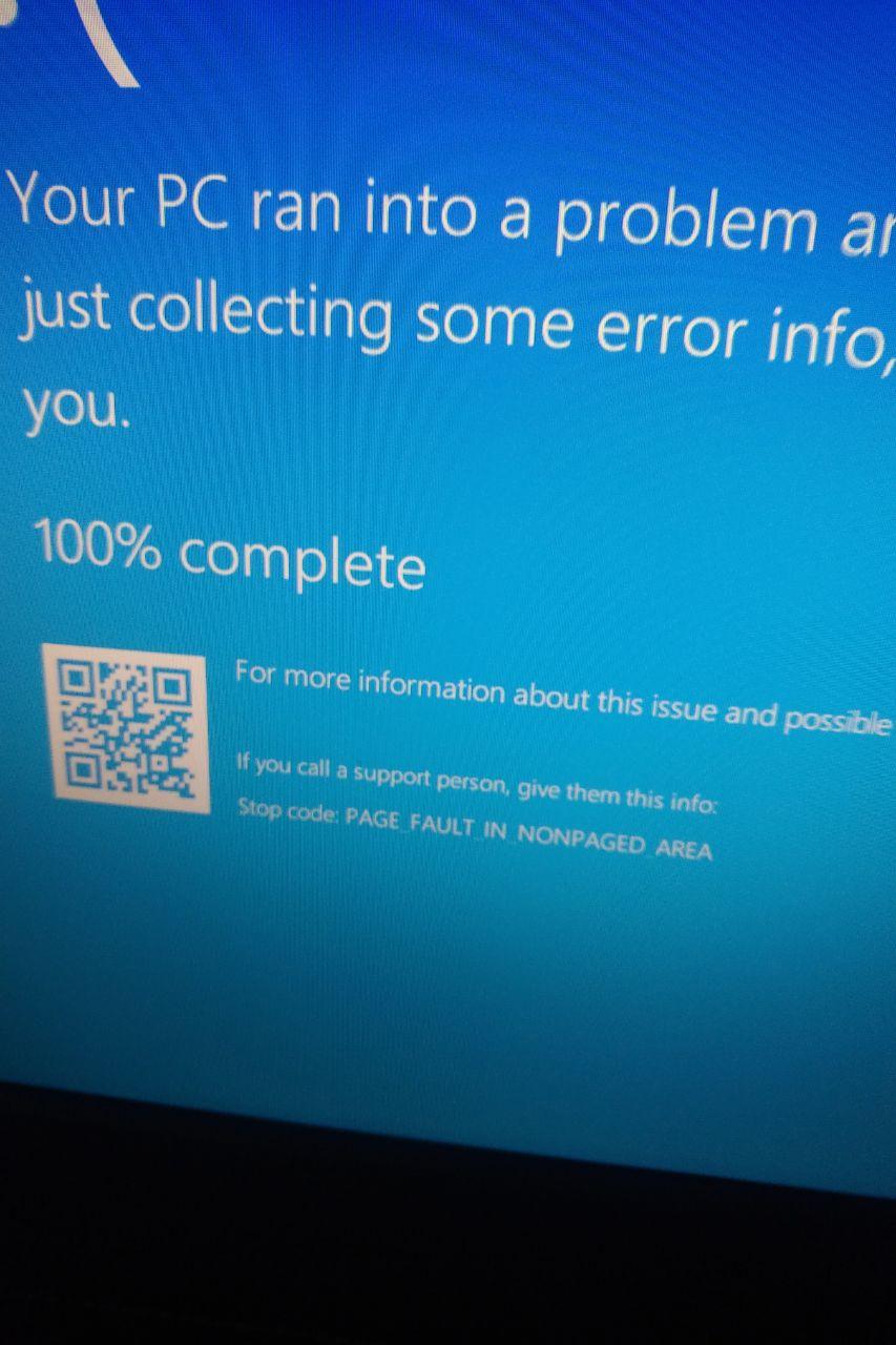

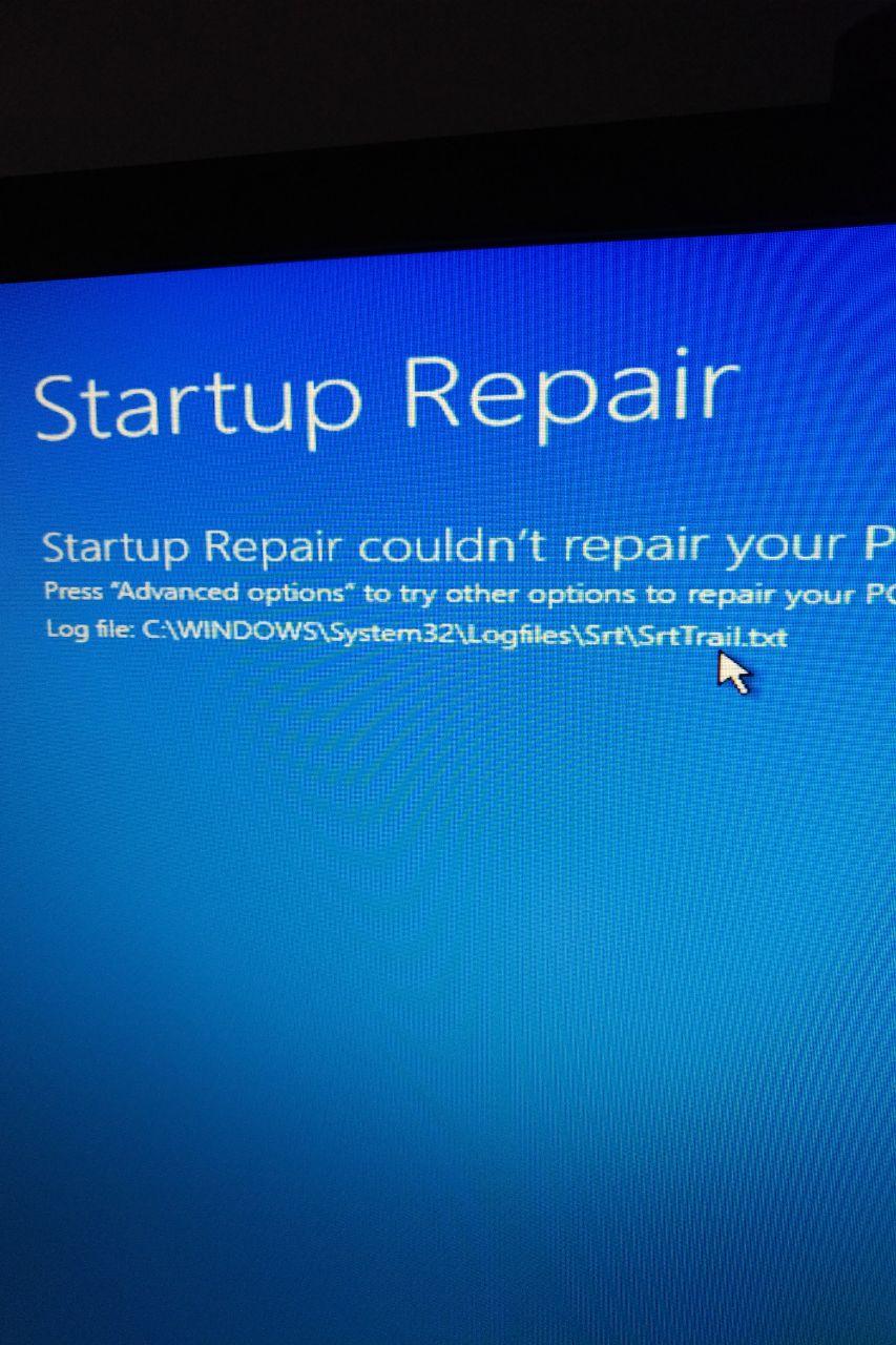

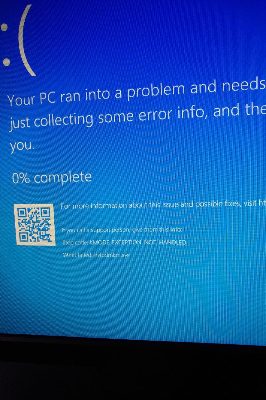

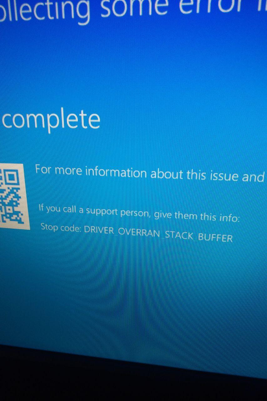

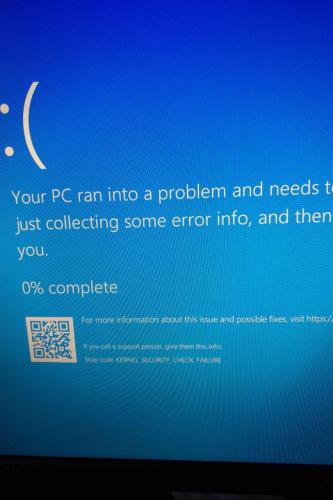

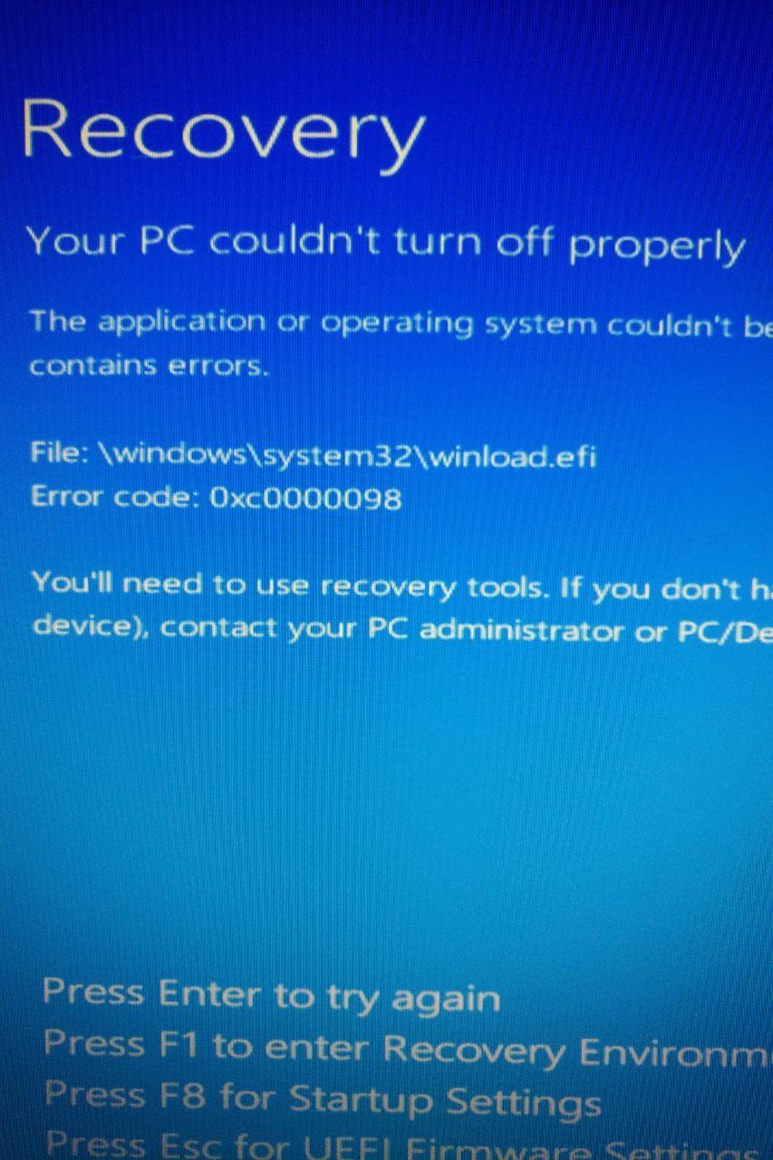

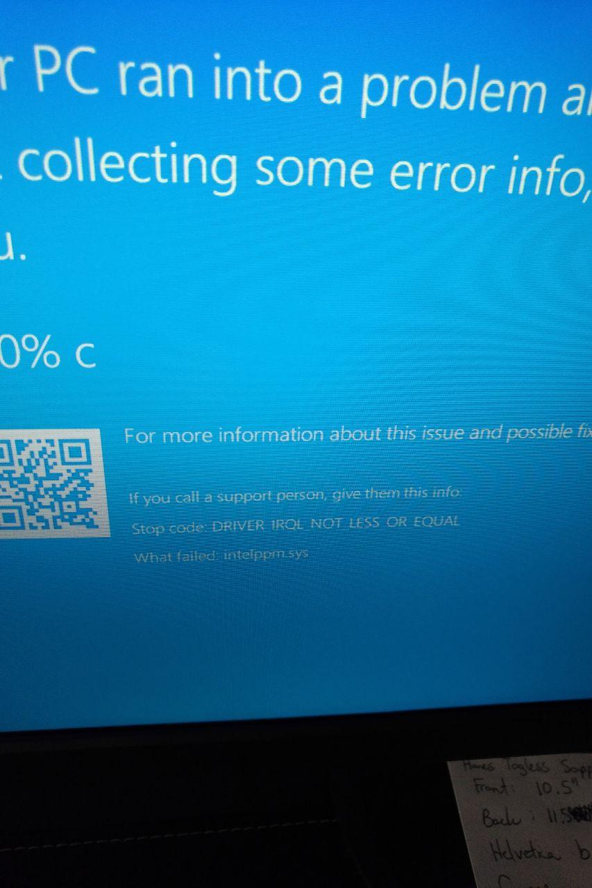

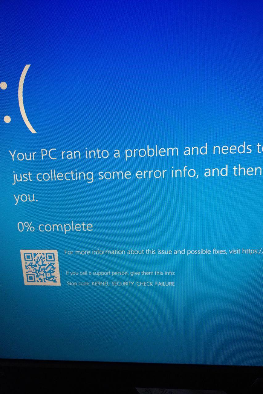

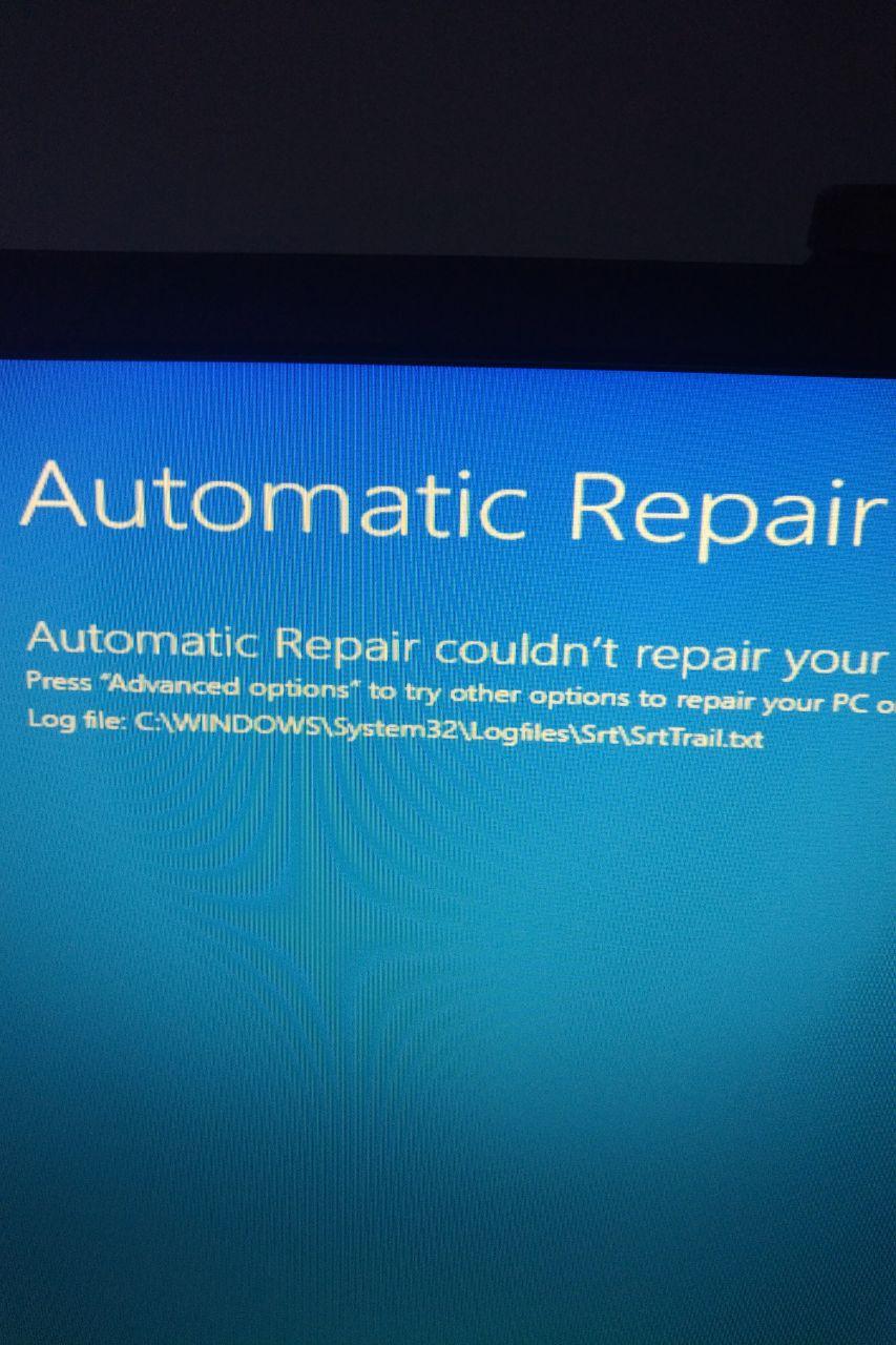

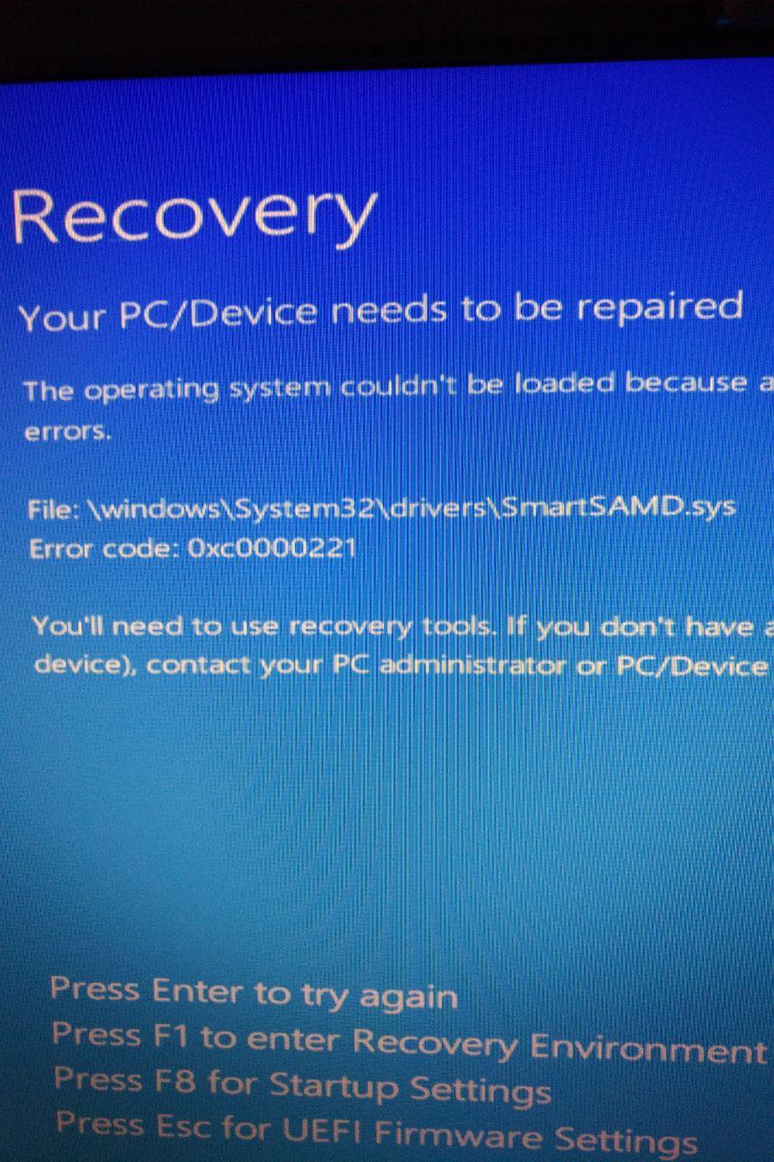

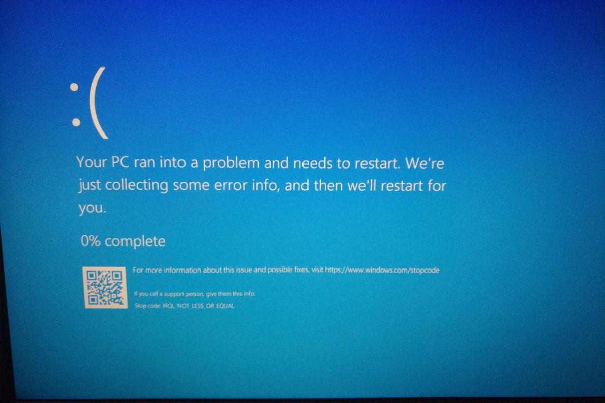

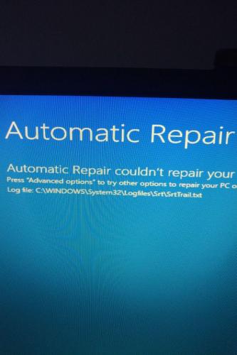

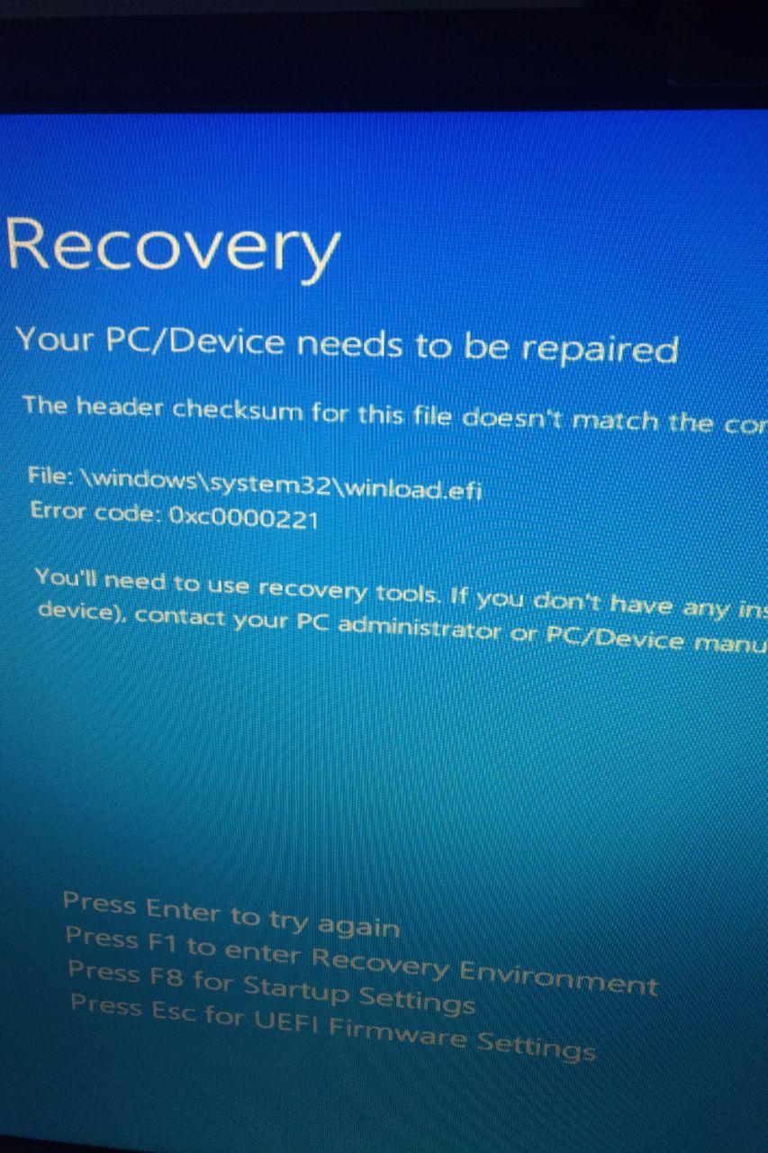

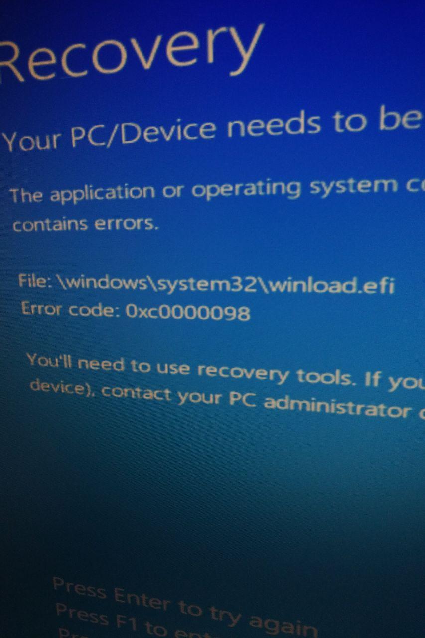

Hi everyone, I've been experiencing numerous, frequent blue screen errors on my desktop for the past few months and I can't seem to figure out exactly why they're happening. I've clean installed Windows 10 and I'm still encountering these errors, so I suspect it may be a hardware issue. I've attached photos of the various blue screen errors I've been getting. Please let me know if you need any more information, thank you in advance for your help.

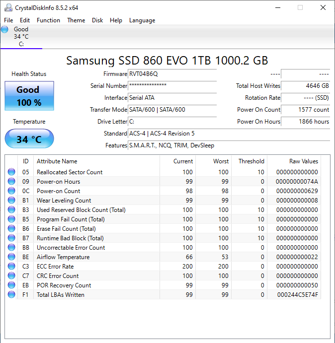

We can see a few errors there and among them is one related to SMART which monitors storage devices and if having issues it may explain your present problems, this is what we will check first;
Download and run CrystalDisk info standard edition from here
Run the program, grab any screenshots and attach to your next reply for us.

Thanks for the screenshot which as you can see shows the SSD in 100% good order.

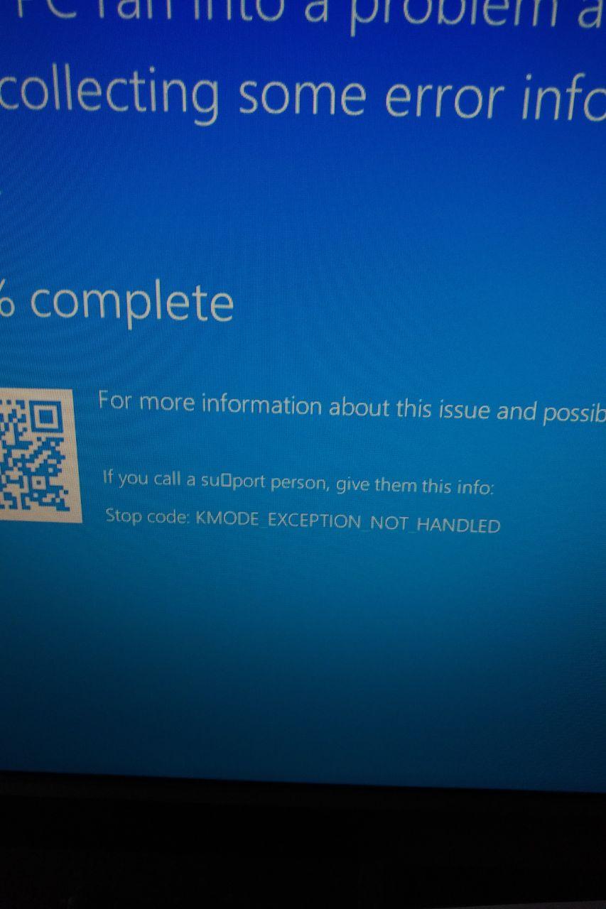

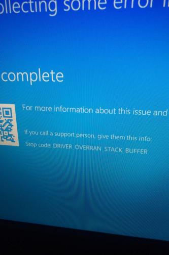

I uninstalled Comodo, updated Windows Defender, and attempted to conduct a full system scan four times. About a minute into starting each full system scan, my computer crashed and I received a blue screen error each time. I've attached a picture of the first error below. I couldn't get a photo of the others, but the second read "system service exception." I checked the minidump folder after rebooting each time, the files have not changed. As of this post I have been unable to conduct a full system scan because of these issues.
