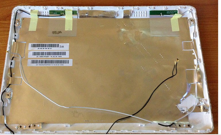

I've poked around under the case and it seems to be working like before although I'll obviously need to monitor it. All I did though was take out and reinsert the wifi card and also pop out/in the two antenna connectors although I had most of the thing stripped as wanted to trace the antenna cable(no sign of any cable/connector damage). If i was replacing the wifi card that would be easy. The antenna would involve a bit more work as there is a connector going up each side of the laptop and each connecting into a small circuit board. Looking at antennas online it seems they are taped on so it's doinable, but patience/diligence is required. See pic from a 1015 model

Alright finally got round to sorting it as the wifi adaptor was draining my battery a lot. Tried replacing the wifi card and it made no difference, but replacing the antennas has! Yippie. I replaced both antennas so won't know it was just one playing up. When putting on the new ones I cut away a large foil sticky panel from anntennas circuit board then realised this was a mistake and kept it on the other one. Either way doing this has no affected the signal, but reckon I'd not cut a bit off again.
