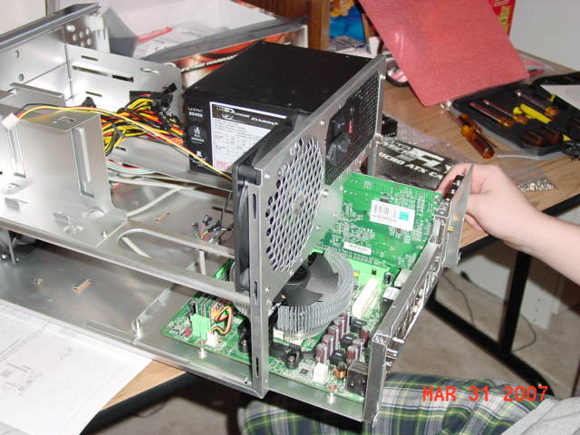

  • 561 posts
heyyyy......
The motherboard sets on a slide out tray
so just slide the tray out to put the motherboard on and everything else
then slide it back in
it can come completely out to work on it
so it's easy to work on, he's working on it now
