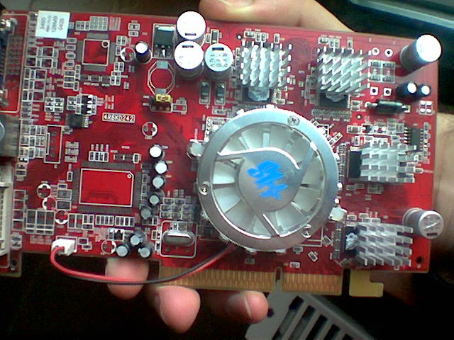

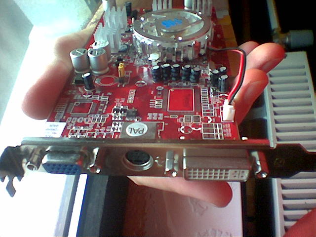

I bought Ati radeon 9600 excalibur 128 MB, 128bit..... I thought I wont have problems with playing new games, doing with grapfics..... I was wrong... :tazz: The games are not working good (breaking) there's no way to stop this even if details are low ;) .... so I check on the web the pictures of my card and they're seems different... I think they sold me 9500 or 9550 with new bios...You can check the picture My_GPU1.jpg and My_GPU2.jpg (the same card). I bought it in a shop (new)... Al informations I can give you is FCC: "ML-1 94V-0" 0422; s/n H040706555 and number 4R8KD242 ..... That's all :)

There is another problem I found.... I think I know why my card is breaking.... Look there are 3 silver capacitors together.... So when I'm playing games one capacitor becomes very hot ( you can't hold it ). From my old experiences: this is happerning when the card is oveclocked... so If they have changed the bios a card is overclocked forever, you are angry because you mean that you bought bad stuff again :) If this is true, how to prove it???

Here is a review of your card for comparison's sake.
http://www.hardavenu...9600vivo1.shtml
It would appear to be based on the 9600se, with slightly faster clock above the standard SE, but still a far cry from the The 9600 xt or regular 9600
It has a 64-bit memory interface rather than a 128-bit memory interfaceyou can expect a bottleneck when enabling features like Anti-Aliasing.
The core engine clock speed is set at 325MHz, rather than 400MHz or 500MHz for the 9600 and 9600xt.
So, not a full blown 9600---but you did not buy a full-blown 9600

gerryf Yes it is possible that isn't full blown 9600... When I run ATItool I can see there Core speed (324 MHz, not 325) an there is RAM speed (202,3 MHz) is this good? If I try overclock it for 1 MHz it becomes unstable..
On a box there is text with specifications: interface 128 bit, 128/256MB, agp 8x and other [bleep] :)
For both of you: look I paid for this one http://nakupi.net/bu...&productId=2352 and It seems they have srew me :) A half year ago It costs about 133 euros.
Between vivo 4R8KB242 and my 4R8KD242 are only "B" and "D" different....
Is it possible that they sent me wrong card?
