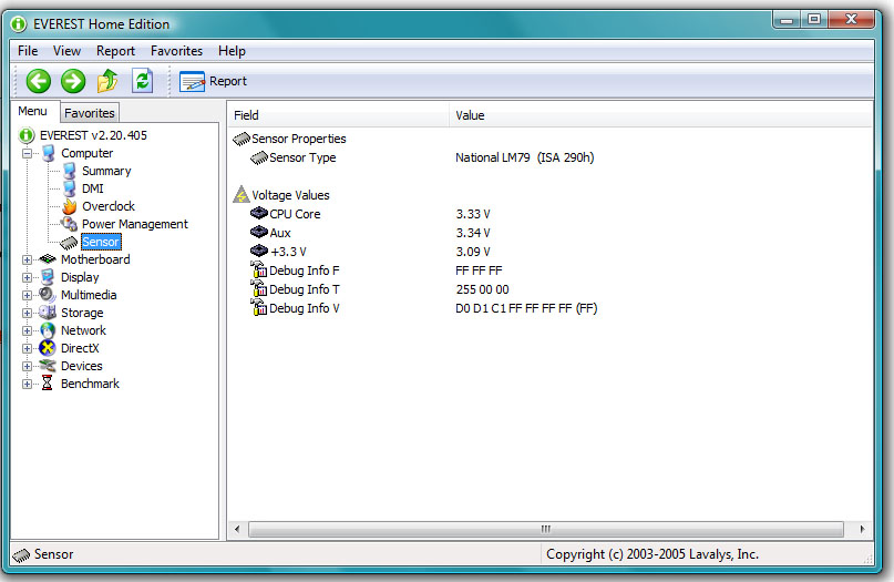

OK then lets take a look at some things and see what pops up on us.
7: Attach to your next reply.
Open it.
2: Click once on Summary
3: In upper menu, go Report

I hope I got it all, those were great directions!
Version EVEREST v2.20.405
Report Type Quick Report
Computer AKI-PC
Generator Aki
Operating System Microsoft Windows Vista Home Edition 6.0.6002 (WinVista Beta)
Date 2010-01-29
Time 20:39
Computer:
OS Service Pack Service Pack 2
Computer Name AKI-PC
User Name Aki
Motherboard:
CPU Type Unknown, 2300 MHz
Motherboard Name Unknown
Motherboard Chipset Unknown
System Memory 1920 MB
BIOS Type Award (10/29/07)
Communication Port RIM Virtual Serial Port v2 (COM4)
Communication Port RIM Virtual Serial Port v2 (COM5)
Display:
Video Adapter NVIDIA GeForce 6150SE nForce 430
Monitor HP w2007 Wide LCD Monitor [NoDB] (CNN7220PQW)
Multimedia:
Audio Adapter High Definition Audio Controller [NoDB]
Storage:
IDE Controller Standard Dual Channel PCI IDE Controller
SCSI/RAID Controller Microsoft iSCSI Initiator
SCSI/RAID Controller NVIDIA nForce Serial ATA Controller
Disk Drive WDC WD32 00AAJS-65VWA SCSI Disk Device (298 GB)
Optical Drive TSSTcorp CDDVDW TS-H653N SCSI CdRom Device
SMART Hard Disks Status Unknown
Partitions:
C: (NTFS) 296154 MB (163556 MB free)
D: (NTFS) 9088 MB (1237 MB free)
Total Size 298.1 GB (160.9 GB free)
Input:
Keyboard Enhanced Multimedia PS/2 Keyboard
Mouse PS/2 Compatible Mouse
Network:
Network Adapter NVIDIA nForce 10/100 Mbps Ethernet (192.168.0.100)
Modem PCI Soft Data Fax Modem with SmartCP
Modem Standard Modem
Peripherals:
Printer HP Deskjet F300 Series
Printer Journal Note Writer
Printer Quicken PDF Printer
Printer Send To OneNote 2007
USB1 Controller Standard OpenHCD USB Host Controller [NoDB]
USB2 Controller Standard Enhanced PCI to USB Host Controller [NoDB]
USB Device Deskjet F300 series (DOT4USB)
USB Device HP Deskjet F300
USB Device Microsoft LifeCam VX-1000
USB Device Microsoft LifeCam VX-1000.
USB Device Realtek USB 2.0 Card Reader
USB Device USB Composite Device
USB Device USB Printing Support
