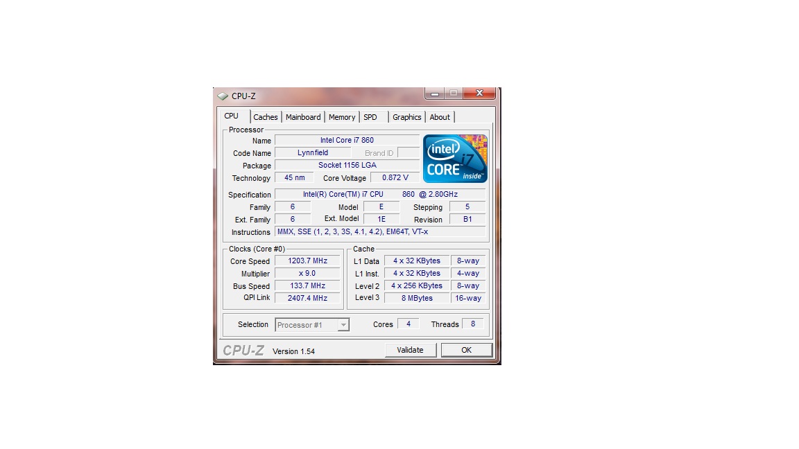

Forsakin
Forsakin
  • 8 posts
The processor info method you posted didnt really give any info, so I downloaded Cpu-Z and took a screenshot of that, hope its what you needed.
Temp of CPU on idle is around 35C with no applications running, GPU around 42-45.
When playing games they both rise roughly 10c but no higher then that -
Cpu has a Corsair Hydro H50 cooler on it btw, is not a stock cooler.
