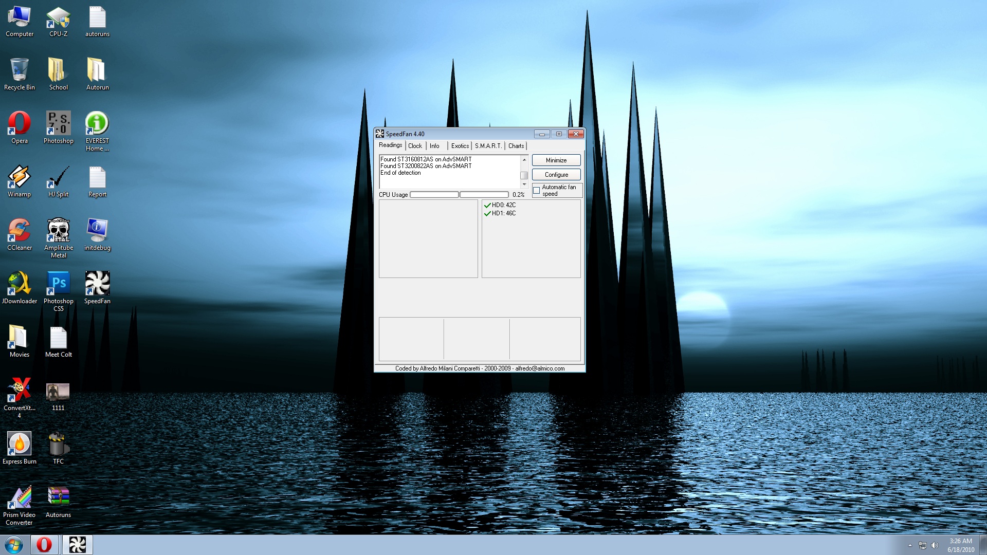

Let's check out system temperatures.
  • Download and install SpeedFan from my signature.
  • Let your computer run for a little bit (to make sure it's warmed up).
  • Run SpeedFan and post a screenshot with the results.

OK, that was a lot :) But here are the results. Thanks for the quick replies. I think I got everything.

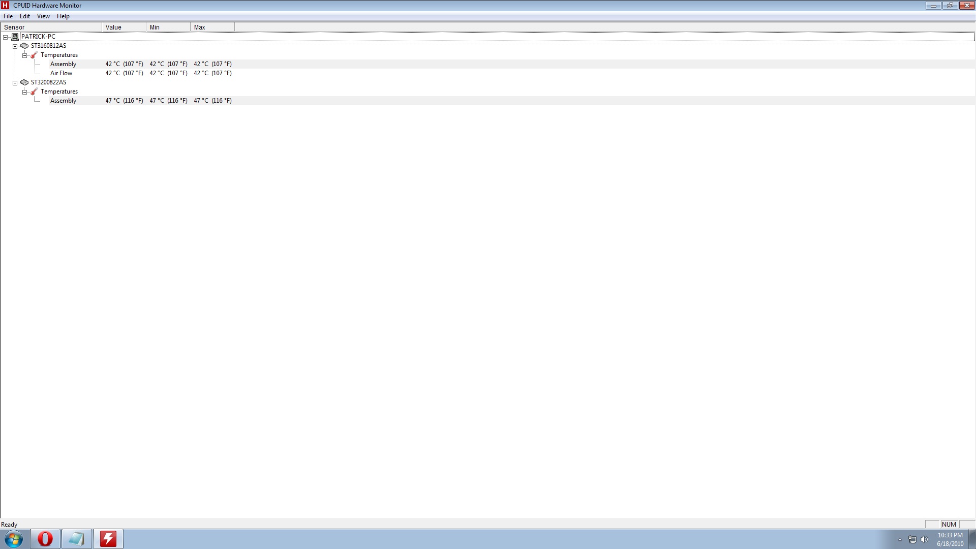

Try using HWMonitor instead of Speedfan.

I agree with diabllic. A download link to HWMonitor can be found here. Please run it and post a screenshot in your next reply.

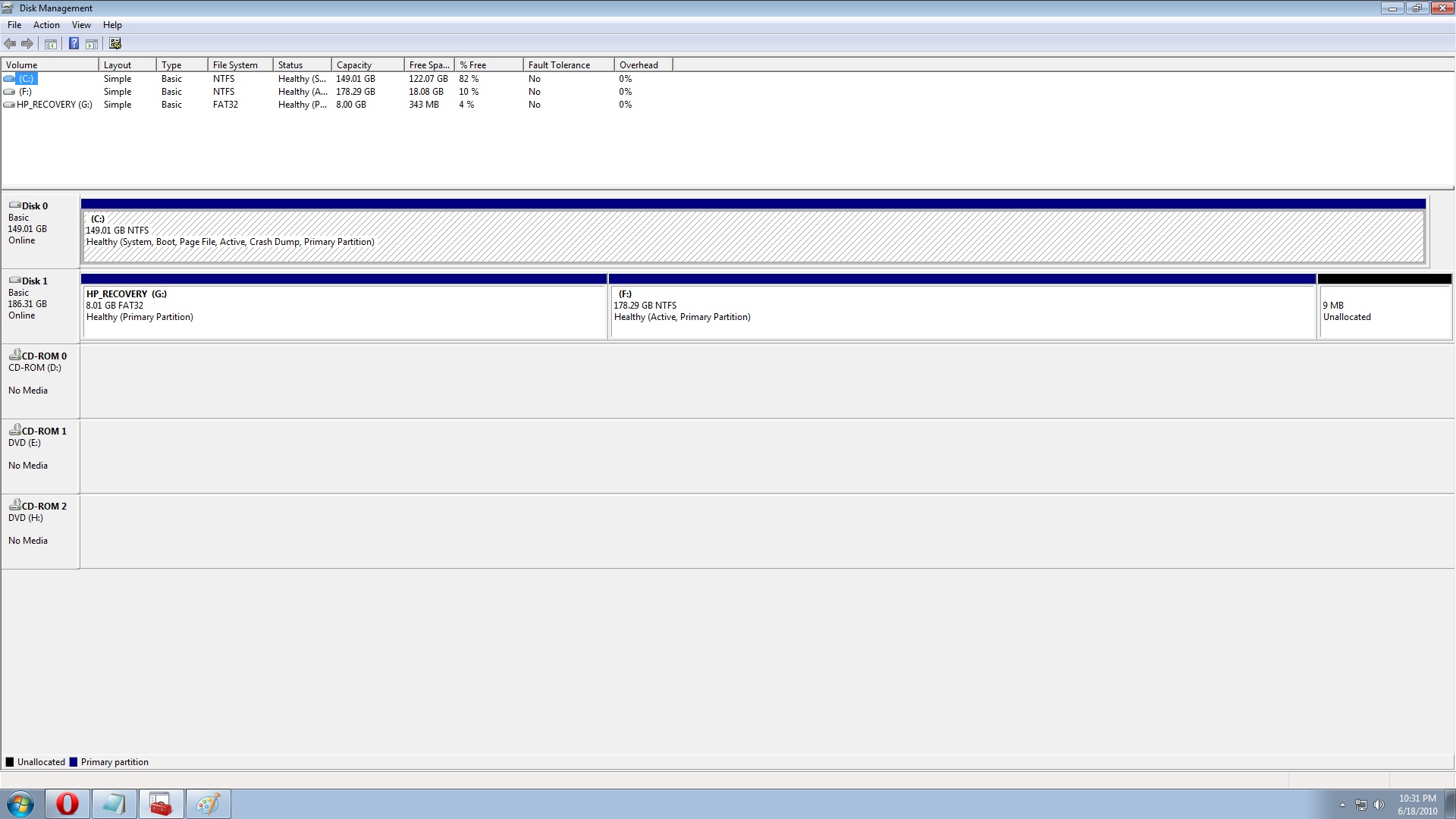

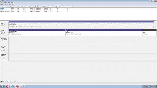

Let's take a look at the partitioning on your computer.
  • Go to Start > Run.
  • Type in diskmgmt.msc and click Enter.
  • On right the side you will see a visual depiction of the partitions on your hard drive. I need you to take a screenshot and attach it to your next reply.

Well after the defrag and cleaning, there is really no difference. Laggyness still exists. Thanks for the responses everyone (and the patience). Here are the two screenshots you needed FNP.

babalonius-
What's the purpose of the F: drive (disk1)?
babalonius
babalonius
  • 6 posts
I use it for extra storage. I installed it after I got the computer. The computer only came with 160gb HDD so I added the 200 gb HDD which is the F:drive.
FNP
FNP
  • 606 posts
The G: volume confuses me. Why is there a recovery partition on a new (purchased) drive?
At any rate, the free space on the F: drive is a little small. Most NTFS drives, for various reasons, need around 15% free space. Because it's not your operating system partition, I don't think it's the reason for your slowdown; however, I would move some data off that drive or format it as a different file system (exFAT or FAT32). That might help with the lag. Let me know how that goes.

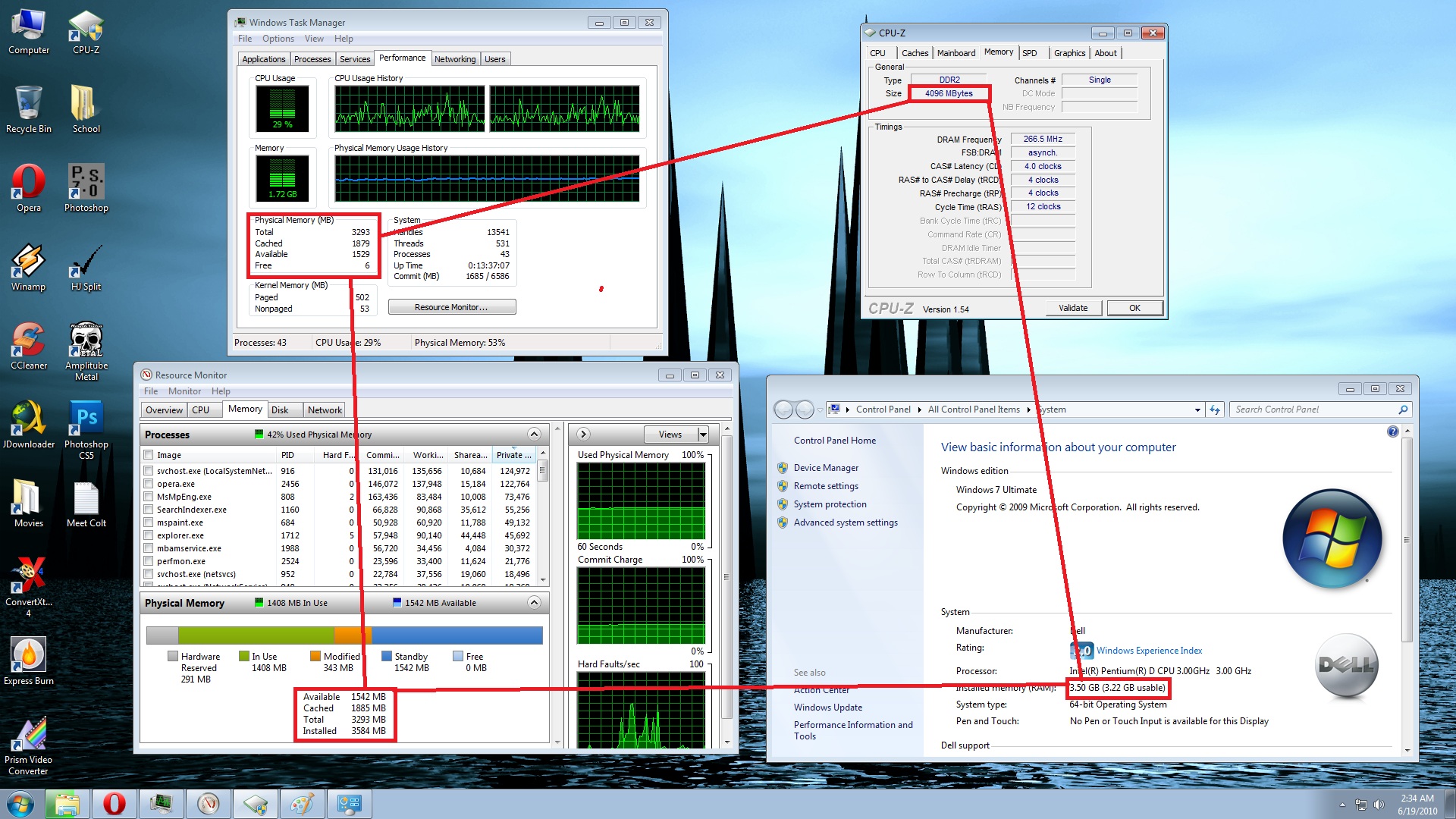

The formatting of the F:drive helped a little but I'm just not seeing the performance I expected when comparing this with my other computer which has lesser specs. The RAM issue is still confusing me too. It says I only have 3.22 gb of "usable" memory and this is confusing to me. Does anyone care to explain why my memory count differs so much? I included a screenshot to show you. I can't help but feel like this may be part of the problem. :)
Also I was wondering, would 32-bit Windows 7 run less laggy than my current 64-bit version?

Okay, the reason why only 3.50 shows up.
Is that any 32x system can only read a maximum of 3.xx gigs of ram and no more then that.
They can only use 32x bits to transfer data, where if you switch to a 64x system the bit width becomes 64, and you can handle more memory I believe the cap for 64x is 128 gigs of memory.
It also takes full advantage of a 64x processor.
where a 32x processor does not.
Some programs will show how much you got installed total like CPUID (Cpu-z)
And others will only show you what you have that you can currently use.
Also Windows 7 requirement for memory is at least too gigs.
If its running laggy, its most likely due to the fact one or some parts are bottle necking the system.
Also if you have on board video, the on board video will suck memory out for itself and doesn't become usable for the system

In addition, processor specs show that the system is capable of handling x64.
And Win7 does not require two gigs of memory to run. The recommendation is one gig, and with tweaking it can run with about 75% of that.
Sounds like part of the system isn't recognizing the ability to run 64 bits. Maybe a bus in the mobo doesn't like you? I'll do some research and see what I can find.
