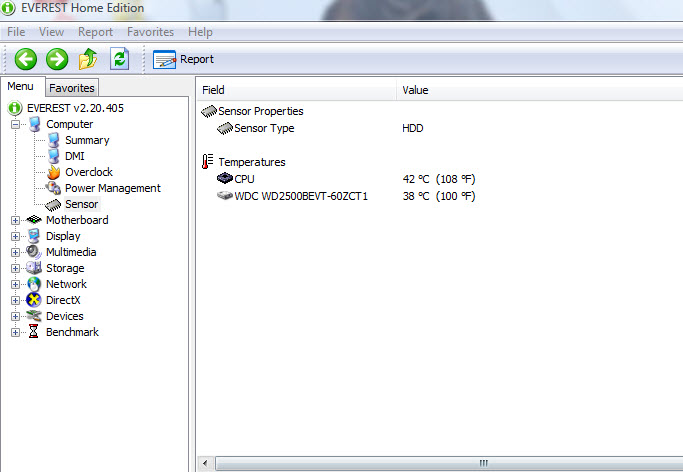

There should be the :
  • Event Viewer log
  • Speedfan screenshot
  • Everest log

Ok :D here it is...
thanks

I just got finished with the "Chkdsk" and nothing seems different... (how would I know?) lol
still seems to be running high and hot.
:D
If chkdsk ran correctly and you watched it then it would have showed any errors and if it fixt them.
Explain what you mean by high and hot please
What is running hot?
Cpu
HD
Optical Drive
Video Card
PSU
Case
Another thing... when was the last time you opened the system and cleaned all the dust using a can of compressed air?
Is this a laptop or desktop?
